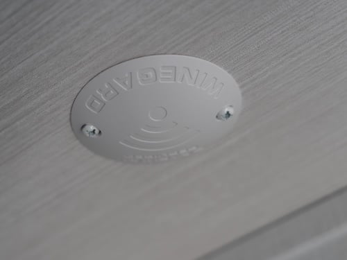

Then, ensure your camper is disconnected from shore power and remove the negative cable from your RV battery to remove power to the antenna. Locate the Winegard-labeled cap in your camper. In most cases, it’ll be mounted to the roof in a central location so that the router, once installed, delivers reliable internet service throughout the floor plan.

  1. Remove the two screws holding the interior cap to the ceiling and pull the 12-volt power cables and three antenna cables down through the hole.

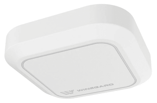

  10. Gently feed all cabling back up through the guide hole in the mounting bracket and push the router onto the bracket’s mating hooks. Then, slide the router until it catches on the hooks and locks into place. You should hear an audible click when it’s locked in place.
Technician Tip: There’s a small release lever on one side of the router. When securing it to the hooks, the router should be installed so that it’s slid in the direction of the lever. To remove the router, gently pull down on the lever and slide the router away from it to release it from the hooks. Then, pull it down.

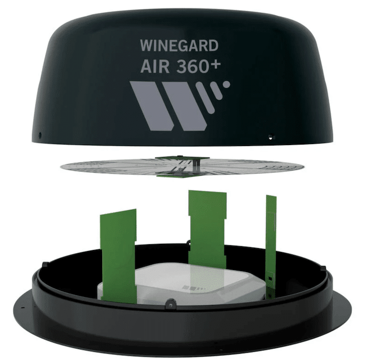

  1. Remove the four screws on the outside of the dome, gently remove the dome, and lay it on its side next to the base to avoid damaging the antenna, coax, or other antennas within the dome.

  7. Neatly organize and secure all cabling before setting the router onto the bracket’s mating hooks. Then, slide the router until it catches on the hooks and locks into place. You should hear an audible click when it’s locked in place.
  8. Test proper operation before reinstalling the dome with the four screws previously removed.
