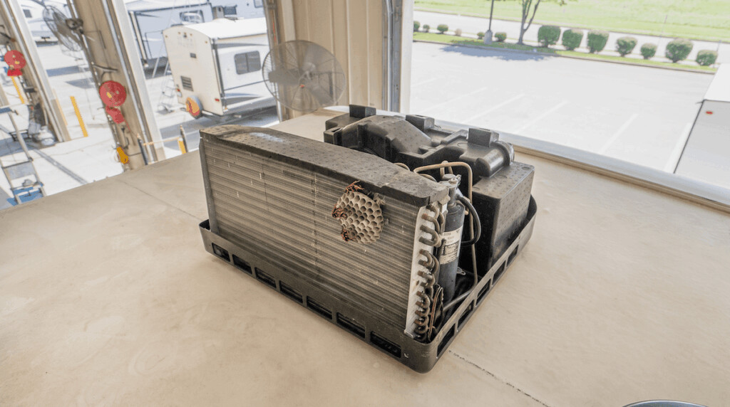

The two most common causes are insect nests in the fan’s hub or blades, and missing or damaged blades.
Wasps, mud daubers, and other insects often build nests in RV AC units during storage, and even a small amount of nesting material can throw the fan off balance. A cracked, chipped, or broken fan blade changes the fan’s weight distribution, causing it to wobble every time it spins. An unbalanced fan puts ongoing strain on the motor and its bearings, and what starts as a vibration issue can accelerate motor wear if left unresolved.

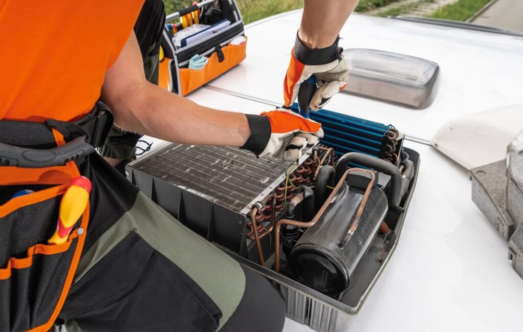

To check:
With the AC off and the RV unplugged from all power sources, remove the cover and visually inspect the fan blades and hub for nesting material, debris, or visible damage. Carefully clear away debris, and if a blade is cracked or missing, the fan will need to be replaced by a certified technician rather than repaired.
