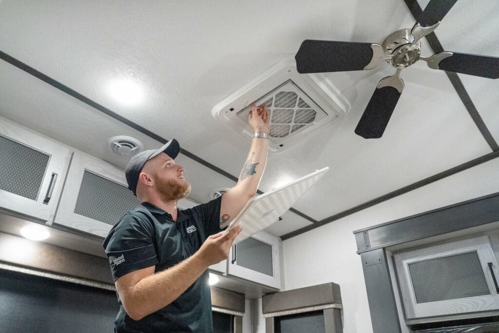

Clogged or Dirty AC Filter

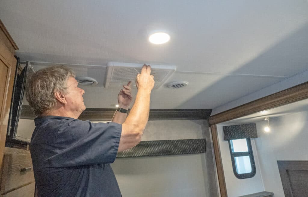

Regular inspection and cleaning of your air conditioner’s filter is arguably the most important DIY maintenance task you can complete for your RV’s cooling system. Most RVers inspect and clean their AC air filter(s) every 3-4 months. Make it part of your post-trip RV cleaning routine, and it’ll always be ready for the next trip.
When an air conditioner filter is too dirty, airflow will be restricted. That lack of airflow, often combined with dirt buildup in the evaporator coil and fins, reduces heat transfer from the air into the coils. This causes the coils to get too cold, and any humidity in the air condenses and freezes on the coils.
This is especially true when the AC has been running for a prolonged period, there are many people in the RV, or activities such as cooking or hot showers are taking place. However, when the AC unit cycles or you turn it off, the coils will begin to thaw, and the moisture frozen on them will drip inside your RV.
To avoid this issue, inspect and clean your air conditioner’s filter and coils at least quarterly, if not more often. If your unit uses a more traditional residential-style air filter, keep a stock of replacement filters on hand for RV air conditioner maintenance.

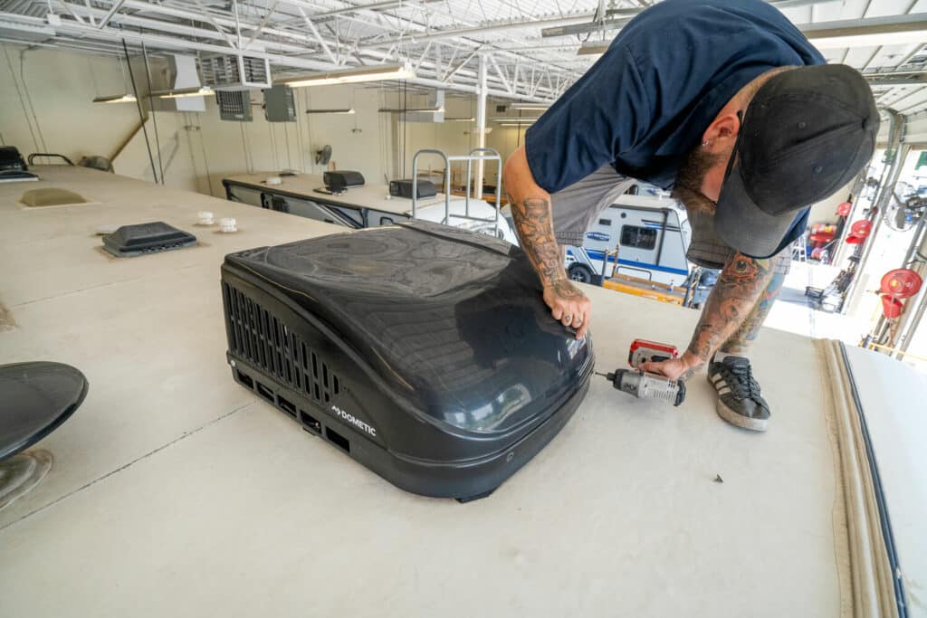

Your RV AC could also leak inside because it wasn’t installed or secured correctly. RV air conditioners have an exterior gasket that must be compressed to the manufacturer’s recommendation. Failure to tighten the unit’s lag bolts to the recommended torque setting can allow water to leak into your RV. Overtightening can also crack the roof and ceiling structure, or create a slight depression in the roof deck, both of which can funnel water into the RV.
An exterior AC gasket doesn’t last forever, either. These gaskets relax and shrink over time, so the AC mounting bolts must be snugged up to the manufacturer’s specifications regularly as part of your other seasonal maintenance tasks. Depending on environmental conditions and the type of foam the gasket is made from, they are generally good for 4-5 years, but must be replaced when they’ve lost their elasticity.
In addition to compressing the air conditioner gasket, the ceiling assembly must be properly secured to the exterior of the roof-mounted air conditioner. The shroud must be secured correctly and free of any cracks or holes allowing water in. The ceiling assembly must be properly installed and fully sealed with foam and foil tape to prevent cool and warm air from mixing, which can lead to overcooling, condensation, icing, and thus water dripping into the RV.
To evaluate potential installation issues that could be causing RV AC leaks inside, visually inspect the shroud and exterior gasket for cracks or other damage. You can also contact the AC manufacturer for their recommended lag bolt torque setting and check that after removing the ceiling assembly panel inside your RV. If the torque specs aren’t available and the 50% compression method is recommended instead, measure the thickness of the uncompressed gasket and stop tightening at half that measurement.
