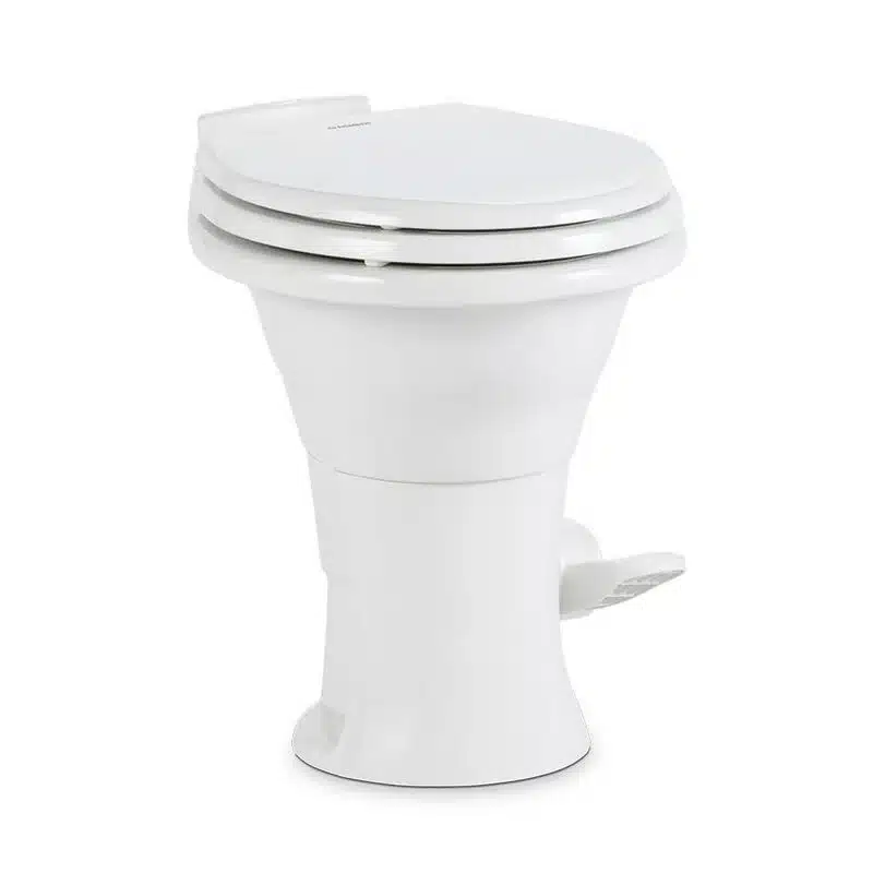

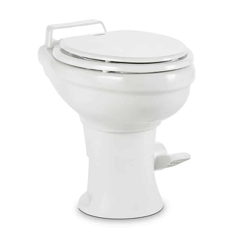

Dometic 320 Series RV Toilet
Don’t let the price scare you—this is the best toilet money can buy for your RV. You’ll hardly notice a difference from the one back home. The residential-height seat, ceramic bowl, and elongated seat make this a must-have toilet for your RV bathroom.
Seat HeightBowl MaterialSeat ShapeWeightRough-In
18”Ceramic/PorcelainElongated37 lbs.11” Minimum

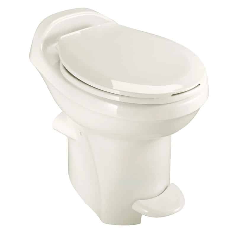

Thetford Aqua-Magic Style Plus RV Toilet
The Thetford Aqua-Magic Style is another premium option for a quick RV bathroom renovation. It has a residential-height seat for ease of use and a ceramic bowl that won’t stain or smell.
17.5”Ceramic/PorcelainElongated45 lbs.11” Minimum

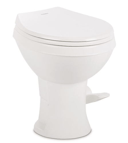

Dometic 400 Series RV Toilet
Like the 310 and 320, the Dometic 400 has a residential-height seat. It differs by featuring a plastic bowl to save weight and a smaller rough-in for easier application in more tiny RVs. It’s a great option for those on a budget.
18”PlasticRound, Soft Close9.5 lbs.7.625” Minimum

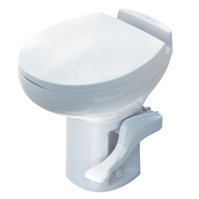

Thetford Aqua-Magic Residence RV Toilet
The Thetford Aqua-Magic Residence is very similar to the Dometic 300 but at a slightly lower price. It was a tall seat for ease of use and a plastic bowl to save weight.
18”PlasticElongated13 lbs.9.5” Minimum
