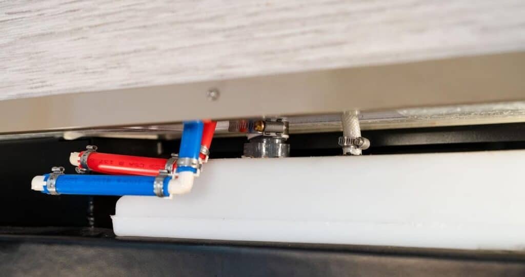

Burst and Cracked Water Lines
Most modern RVs use PEX tubing, which is flexible enough to expand somewhat as water turns to ice. But the weak points are the rigid brass or plastic fittings at every joint, elbow, and connection point in the system.
When water freezes and expands inside those fittings, they often develop a hairline crack that holds up when the system isn’t pressurized but causes an issue immediately when the water pump is turned on or a city water connection is hooked up. This is why burst and cracked water lines can go undetected. The fitting looks intact, and the line holds shape until the system is pressurized and water appears where you don’t want it.
Where damage is most likely to occur:
  • Low-point drain connections, where fittings are close to unheated exterior surfaces
  • The water pump inlet and outlet connections
  • Fittings in unheated underbelly runs, particularly near slide-out mechanisms
  • Any line running close to an exterior wall in a portion of the RV without a heated underbelly

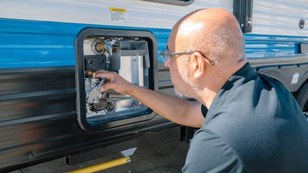

Water Heater Damage
The water heater is the most expensive plumbing appliance that freeze damage can destroy. A standard six or 10-gallon RV water heater tank retains water even after normal use. If you skip critical steps when draining the water heater during winterization (more on the winterizing process in a link at the bottom), residual water left in the tank can freeze, expand, and crack the tank. This kind of damage requires full water heater tank replacement.
A crack won’t become apparent until the system is running in the spring. Symptoms include a lack of hot water production caused by dislodged internal plastic components in the check valve, water pooling near the exterior water heater compartment door, rust staining or mineral deposits around the drain port, or a weeping pressure relief valve.
Tankless water heaters don’t have a vulnerable reservoir tank like standard models, but they retain water in the heat exchanger and mixing reservoir, which can be damaged when retained water freezes and expands. Always follow your tankless water heater manufacturer’s specific instructions recommending (or advising against) adding antifreeze when winterizing.
For a full walkthrough of the process, see our guide to winterizing an RV tankless water heater.

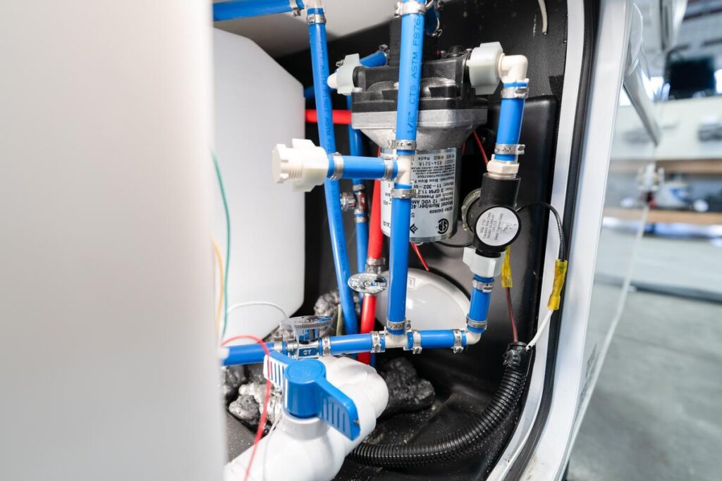

Water Pump Failure
Your water pump’s housing is typically made of rigid plastic or cast metal and cannot flex under expansion pressure. A freeze event can shatter a pump housing because the water inside the pump has nowhere to go as it expands. The internal mechanism that pressurizes the water, known as the impeller,  is similarly vulnerable, even if the housing doesn’t crack. Additionally, the nylon pump valve assemblies can stretch even if the pump frosts, but doesn’t freeze hard.
How damage presents in spring:
  • The pump runs but produces little or no water pressure.
  • The pump makes grinding, rattling, or high-pitched sounds on startup that weren’t present before storage.
  • The pump cycles on for a moment as the pressure bleeds off. The more frequent the cycling, the more severe the damage.
  • The pump occasionally cycles on and off on its own.
  • Visible cracks or splits in the pump body or at the inlet/outlet fittings, or a slight drip under the pump.
  • The pump runs continuously without building or holding pressure.
Pumps mounted in unheated exterior compartments or in underbelly areas without thermal protection are significantly more vulnerable than pumps located inside the heated living space. If your pump is in an exposed location, it should be near the top of your pre-freeze checklist.
