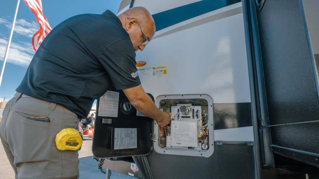

Water Heater
Yes, in nearly all cases.
Thermostat failures, heating element replacements, and anode rod swaps are straightforward on-site repairs for an experienced mobile tech. As long as the correct parts are available or on the truck, most water heater calls are resolved in a single visit.

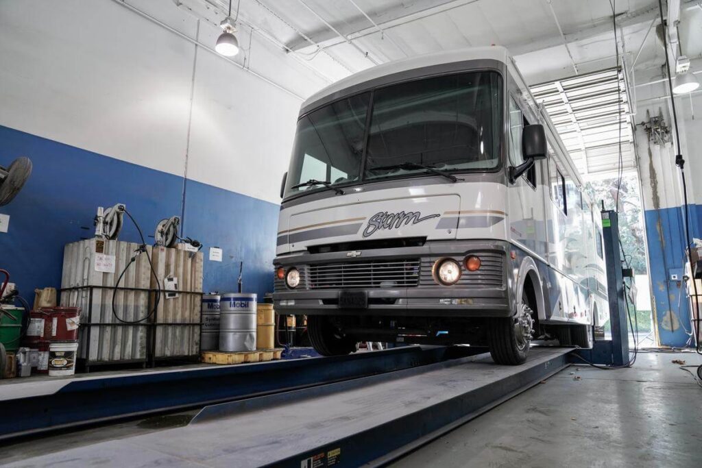

What Typically Requires a Service Center
Not everything can be resolved in a driveway or at a campsite. The most common reasons a repair needs to move to a controlled shop environment with specialized equipment include:
  • Major structural repairs — roof, frame, or sidewall damage
  • Extensive water damage remediation — water intrusion that has caused widespread rot or delamination, requiring disassembly work
  • Engine or transmission work (motorhomes) — chassis-level mechanical repairs
  • Delamination repair — repairing separated fiberglass or laminate panels
  • Repairs requiring alignment equipment or a lift — anything involving suspension, wheel alignment, or underside access
If your issue falls into one of these categories, a mobile technician can still provide an accurate on-site diagnosis before you commit to towing, which helps you avoid paying for a diagnostic twice and gives you a clear idea of what to expect once the RV reaches a shop.

Can a mobile RV technician work on a motorhome’s engine or chassis?
Generally no. Mobile RV technicians specialize in living quarters systems rather than the engine, transmission, or chassis components. Motorhome engine and chassis work typically requires an automotive mechanic (sometimes with diesel experience) or an automotive/chassis shop with the right lift and diagnostic equipment.
