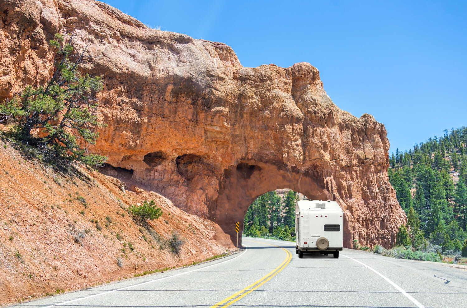

Know Your Travel Trailer’s Height
Measure the height of your trailer or find it in your owner’s manual. Post that height on a sticky note somewhere you can see it while driving. That will remind you how much clearance you need when going under bridges and overpasses.
To avoid height issues altogether, map out the best route for towing a trailer to your preferred destination before you leave. Use an RV GPS system to plan a safe, friendly route that avoids low clearances, road construction, and other obstacles. This will help you avoid detours that add hours to your driving time.

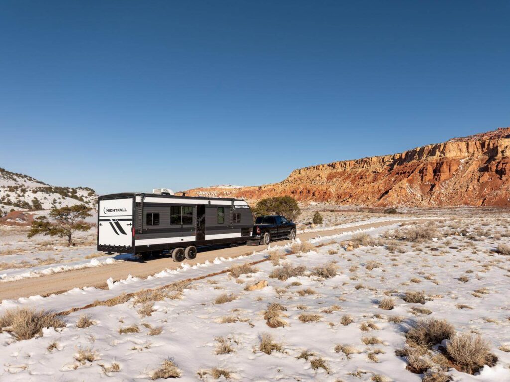

Tips for Driving in Inclement Weather
Wind isn’t the only weather concern. Rain, snow, ice, fog, and poor visibility can all impact towing safety—and may be reason enough to reconsider your drive.
Use your preferred weather app to check the weather frequently along your route. Radio stations broadcasting road alerts and weather warnings along your route are another excellent resource. As a rule, if the lights on those road condition signs are flashing, tune in to the advertised station to learn why.
Just like the wind, it’s better to pull off and wait for a storm to pass than to drive into unsafe conditions.

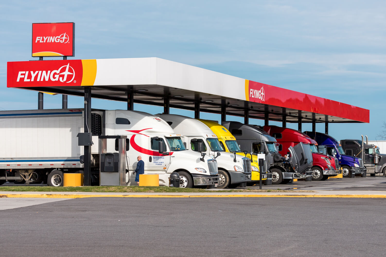

Plan Gas Stops
Even refueling, which is normally quite simple, can be challenging when towing a travel trailer. That’s why many experienced RV owners use a trip planning app to identify gas stops in advance. The best gas stations for RV stops will offer ample space to pull in and out of pumps, and some will add amenities like dump stations, pet walks or enclosed runs, and even overnight sites with RV hookups.
Travel centers and truck stops along major highways won’t be hard to find, but advance planning can also help you find navigable gas stations in more remote locations.
