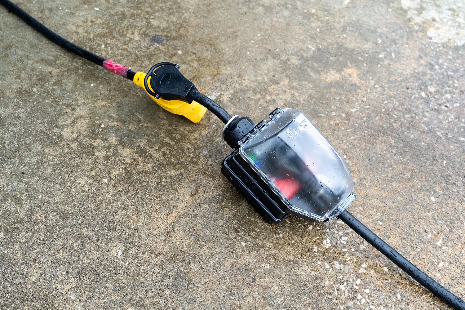

Surge protectors plug into the outlet where you would plug in your RV. Then, you plug your RV power cord into the surge protector. It is a buffer between your RV and the power of the electrical outlet.
This intermediary device monitors the power from the outlet and prevents power spikes from reaching your RV.

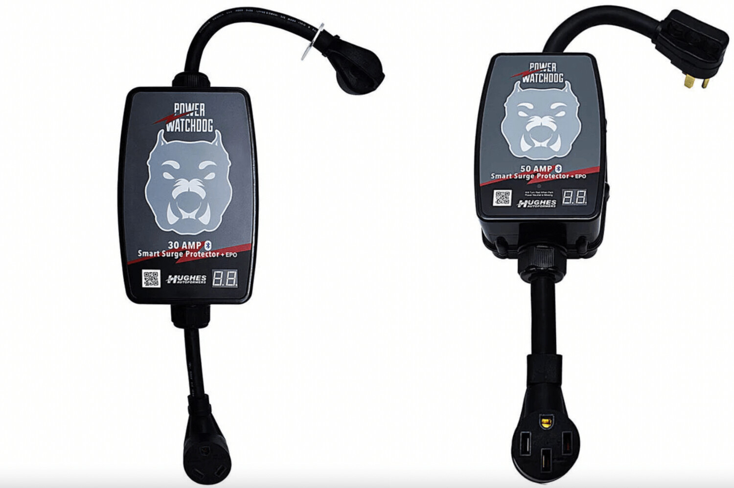

1. Hughes Autoformer Watchdog 30 and 50 Amp Surge Protectors
The Hughes Autoformer Watchdog is available in 30-amp and 50-amp models. These surge protectors have gained popularity largely because of their emergency power-off feature. They’re also heavy-duty, weather-resistant designs with Bluetooth® capability to track power levels from your smartphone.
Technician Tip: These might be the best things out there today. They protect extremely well against all conceivable faults and automatically reset when the danger has passed. If components are permanently damaged, they are also user-serviceable in the field.

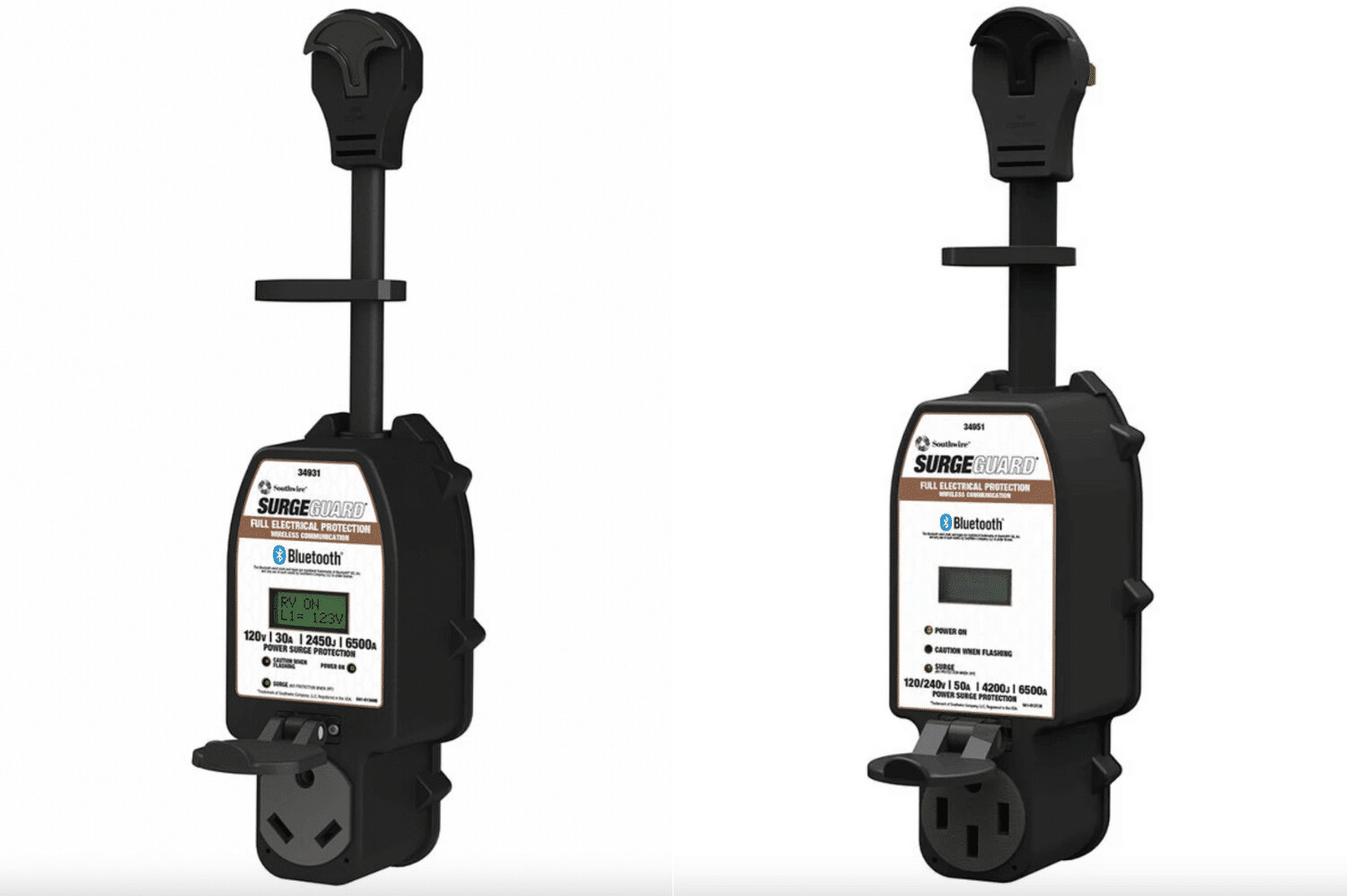

2. Southwire Surge Guard Portable 30-Amp and 50-Amp Surge Protectors
This Southwire Surge Guard also offers models for 30-amp RVs and 50-amp coaches. It protects against various wiring issues, including reverse polarity, open neutral, and open ground. The units feature a locking bracket — making this a great locking RV surge protector option — to prevent theft once they’re in place.
The Southwire Wireless LCD Display complements the wireless capabilities of these surge guards. It provides total visibility for easy monitoring of your surge protector and the status of the connected power source.

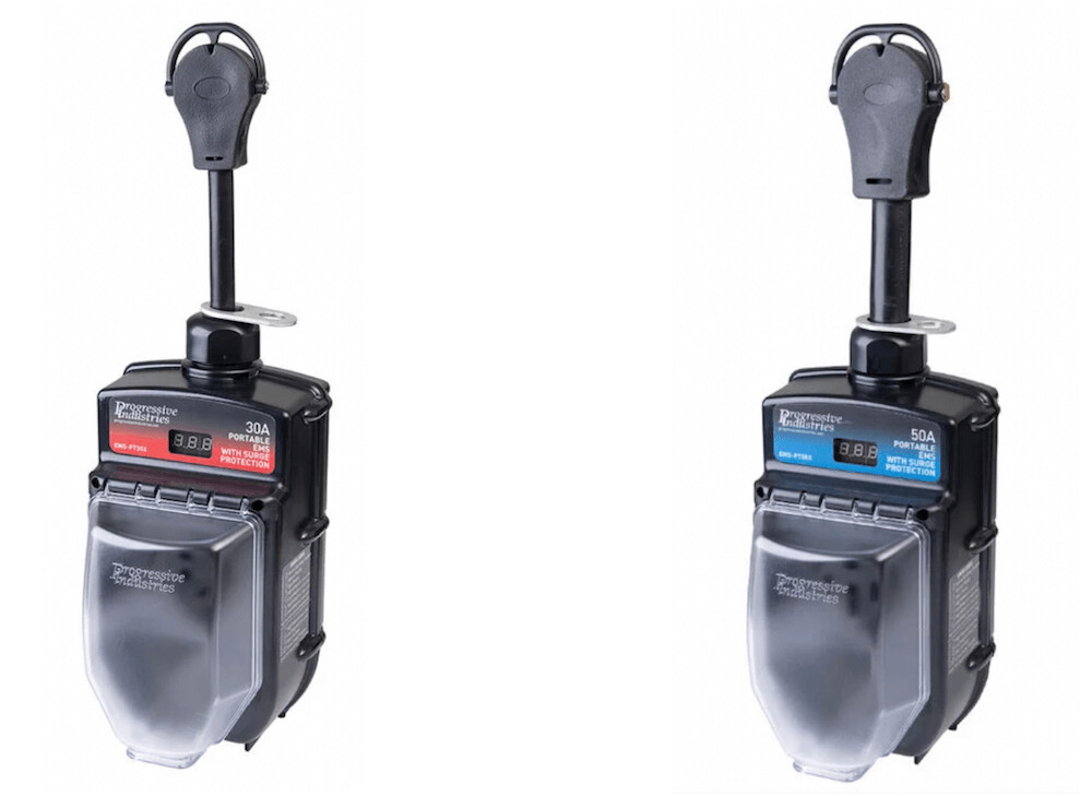

3. Progressive Industries EMS-PT30X and EMS-PT50X Surge Guards
Progressive Industries’ EMS-PT30X and EMS-PT50X surge protectors are excellent electronic management systems for RVs. They protect against various electrical issues, including high and low voltages, open ground, open neutral, and reverse polarity.

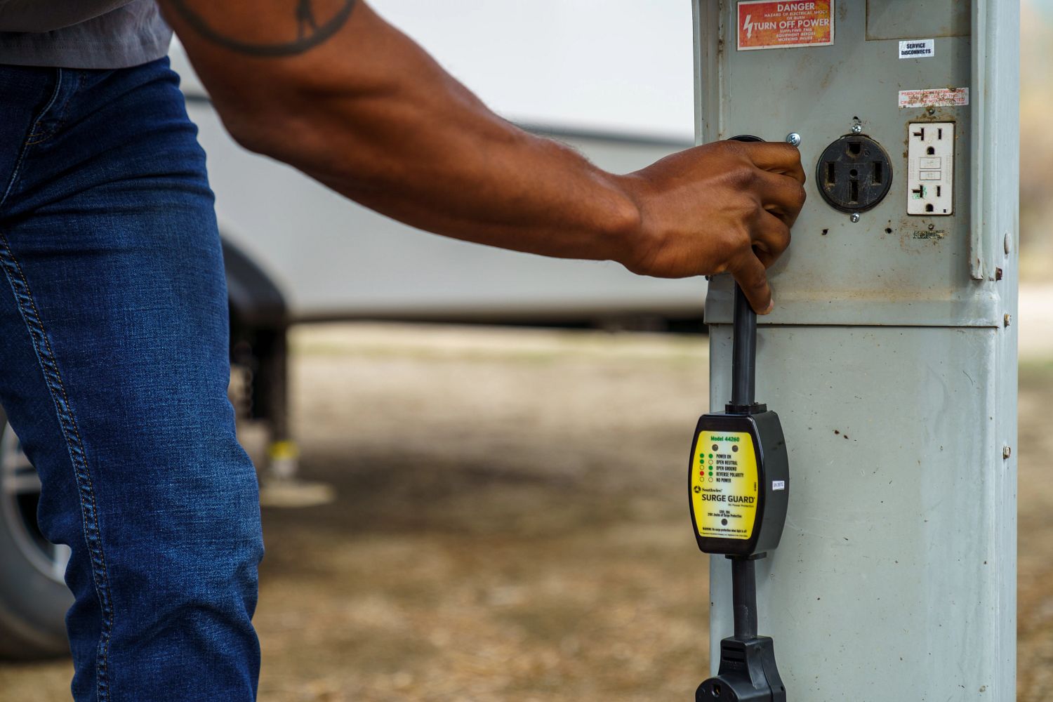

A portable surge protector for your RV plugs directly into the campground pedestal before you connect the power cord. These are the most common because they are easy to use, require no installation, and can be transferred between RVs.
