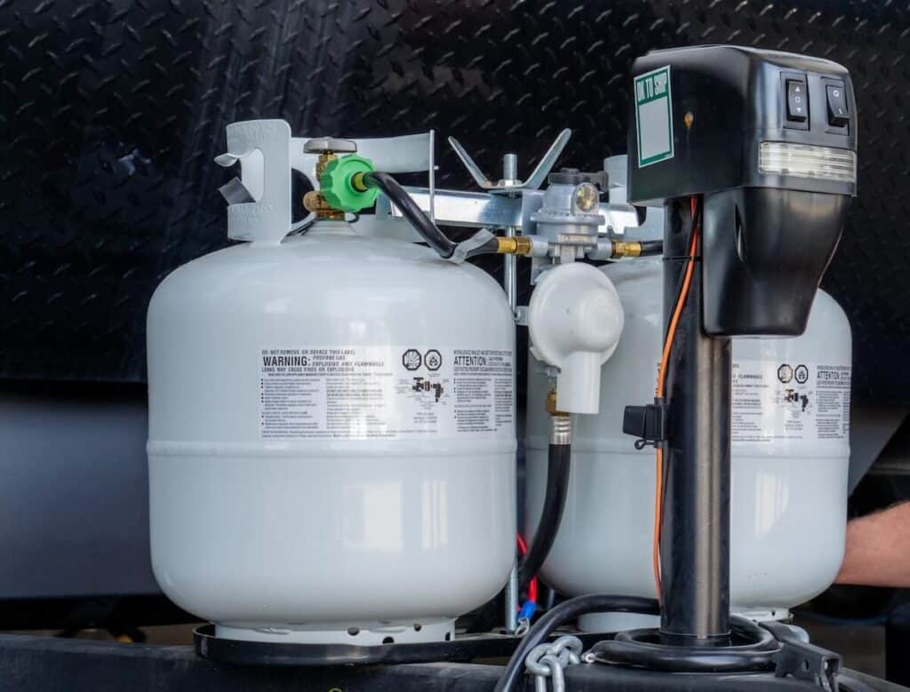

The LP regulator is the foundation of propane safety in your RV. Whether you’re in a motorhome with a built-in LP tank or a towable camper with propane cylinders, your entire propane system depends on this single component functioning correctly.
Propane is stored at high pressure inside your container(s). The regulator’s job is to reduce that pressure down to a safe, consistent level that your cooktop, furnace, water heater, and other appliances can use. Without a functioning regulator, propane would reach those appliances at dangerously high pressure.
Single-Stage vs Two-Stage (Automatic Changeover) Regulators
For RVs with a single LP container, a single-stage regulator handles the pressure drop from the container to the appliances. But for towable campers with multiple propane cylinders, you’ll typically find an automatic changeover regulator. This device monitors the supply and, when the active cylinder runs low, automatically opens the line from the backup cylinder so your appliances keep running without interruption. Of course, this relies on the valves on both cylinders being fully opened.
You can usually tell which cylinder is active by the indicator window on the regulator: green typically means the active side is still supplying gas, while red signals that the regulator has switched to the backup side and it’s time to refill or swap the depleted cylinder.
Technician Tip: When connecting propane cylinders after a refill, open the valve slowly to allow the regulator to equalize pressure gradually. Opening it too quickly can trigger the excess-flow valve inside the regulator, temporarily cutting off gas flow and leading you to think you have an empty cylinder when you don’t.

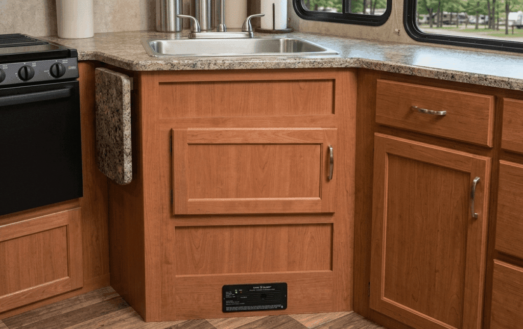

Usually found beneath the kitchen counter or near the refrigerator, the combination carbon monoxide and propane leak detector is one of the most critical safety devices on your RV.
This single device simultaneously monitors two different invisible threats, and its placement is not arbitrary.
Why Placement Matters
Propane (LP gas) is heavier than air. If it leaks from a fitting, hose, or appliance connection, it sinks and pools near the floor. NFPA standards require the LP sensor in an RV detector to be mounted within 20 inches of the floor for this reason.
Carbon monoxide behaves differently. It’s approximately the same density as air and disperses more evenly throughout the interior space. But because priority is given to the heavier-than-air LP gas hazard, keeping the combined detector low effectively covers both threats.
One more thing about placement: keep the detector away from entry doors, floor vents, or ceiling fans. Drafts can disperse leaking gas before it reaches the sensor, potentially delaying the alarm during a slow leak.

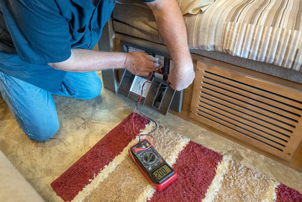

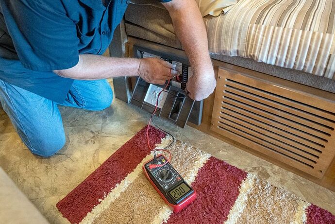

Battery Voltage and “The Chirp”
Because RV LP/CO detectors are typically hardwired into the RV’s 12-volt electrical system, they are sensitive to battery voltage. Most units operate reliably above 11.6 volts DC and remain functional down to approximately 10.6 volts. Below that threshold, you’ll hear one chirp per minute. This isn’t because of a gas leak, but because the detector doesn’t have enough voltage to operate properly.
This matters especially when you use your battery disconnect switch to prevent parasitic drains during storage. When the disconnect is engaged, the LP/CO detector loses power and effectively shuts off. Remember the rule: “Store Mode = Safety Off”. If you’re leaving your RV unattended for an extended period, be aware that this safety system is offline.
Technician Tip: Many modern digital control systems specify 11.6 volts DC or higher, so this is the safest recommendation. If you start your campout at 10.6 volts DC and assume you’ll be fine because you are strictly speaking within spec, you are too close to failure to safely rely on it. There are still many battery-powered models that run on 9-volt and 1.5-volt AA batteries. The minimums for these would be 8.4 volts and 1.3 volts, respectively.

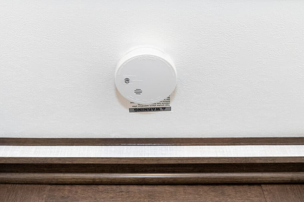

While your LP/CO detector monitors for dangerous gases, your RV smoke alarm is designed to detect smoldering and fast-flaming fires. And like the LP/CO detector, RV smoke alarms have specifications that serve a purpose.
Why Smoke Alarms Must be “Listed for RV Use”
Residential smoke alarms are designed for a stationary environment with relatively stable temperatures and minimal vibration. Your RV experiences none of those conditions. Road vibrations, temperature swings, and the physical movement of driving all put stress on alarm components that a home unit was never built to handle.
This is why NFPA standards specify that RV smoke alarms must be “Listed for RV Use.” These models are tested to withstand the mechanical stress of travel and the temperature extremes of a camping environment. Installing a residential smoke alarm in your RV is not a compliant substitute, even if it’s the same brand and looks identical.

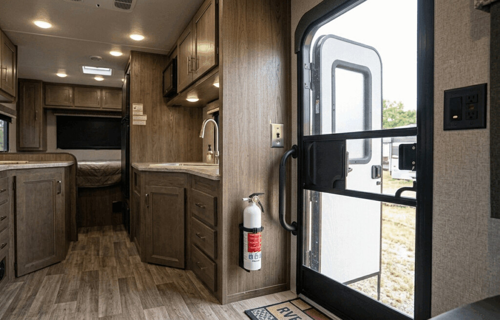

Federal Requirements for RV Fire Extinguishers
Federal regulations require RV fire extinguishers to be Class 10-B:C minimum, per NFPA standards. This classification is specifically formulated for the two most common fire types in an RV:
  • Class B: Flammable liquids (propane, gasoline, cooking oils)
  • Class C: Energized electrical equipment
By law, fire extinguishers must be placed within 24 inches of the main entrance or primary escape route. This NFPA requirement is designed to ensure you can reach the extinguisher without going deeper into a burning structure.

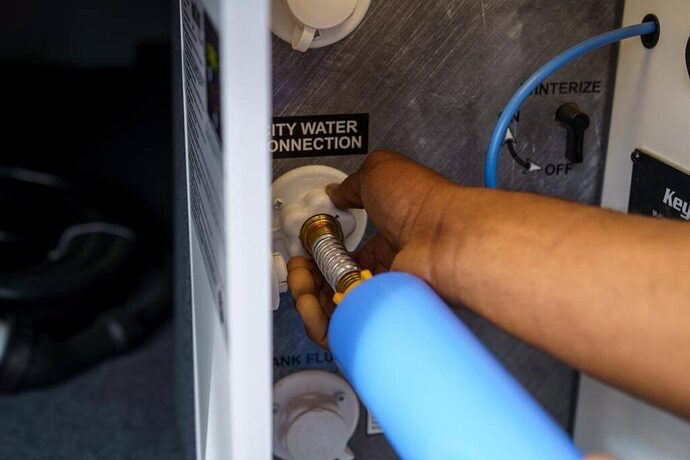

Check Valves: One-Way Protection
Your RV’s water system includes check valves at two critical points: the city water inlet and the water pump. These valves allow water to flow in a single direction only, which serves several protective functions:
  • The check valve at the city water inlet prevents water from flowing backward out of your RV’s plumbing when your water pump is running.
  • The check valve at the water pump prevents water from your plumbing lines from flowing back into your fresh water tank when connected to city water.
Together, they maintain pressure integrity and protect the pump and the overall system from contamination and damage.
One critical warning about the city water inlet check valve: never manually depress or probe it. This valve is designed to open only under pressure from an external water source. Physically pressing it open can cause irreversible damage to the valve seat, leading to backflow and expensive repairs.

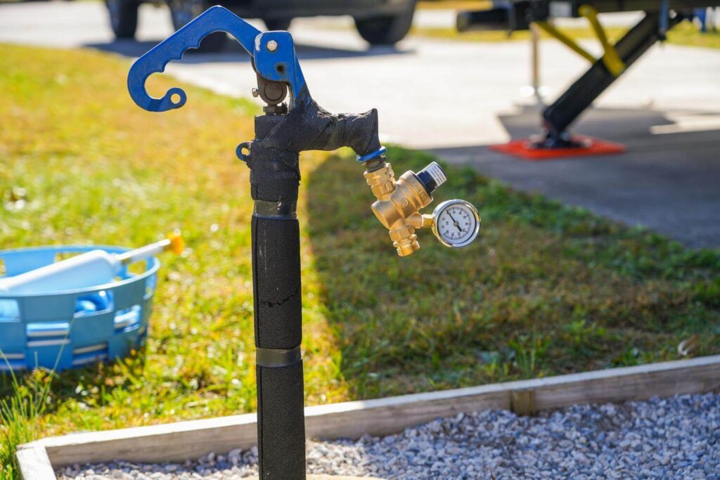

The Water Pressure Regulator
Every time you connect your RV to a campground city water source, you’re exposing your plumbing system to an unknown pressure. Campground spigots can deliver water at anywhere from 40 to well over 100 PSI. Most RV plumbing systems are not built to withstand sustained high pressure. Cracked fittings, burst hose connections, and leaking water lines are the common consequences.
Installing an aftermarket water pressure regulator between the campground spigot and your water hose reduces incoming pressure to a safe range, typically 40–55 PSI, before it ever reaches your RV’s plumbing. Most experts recommend never allowing pressure to exceed 60 PSI.
For the best protection, connect your pressure regulator directly to the campground spigot, then attach your water filter and potable water hose downstream of the regulator. This ensures that your filter, hose, fittings, and plumbing lines are all protected from the moment water starts flowing.
