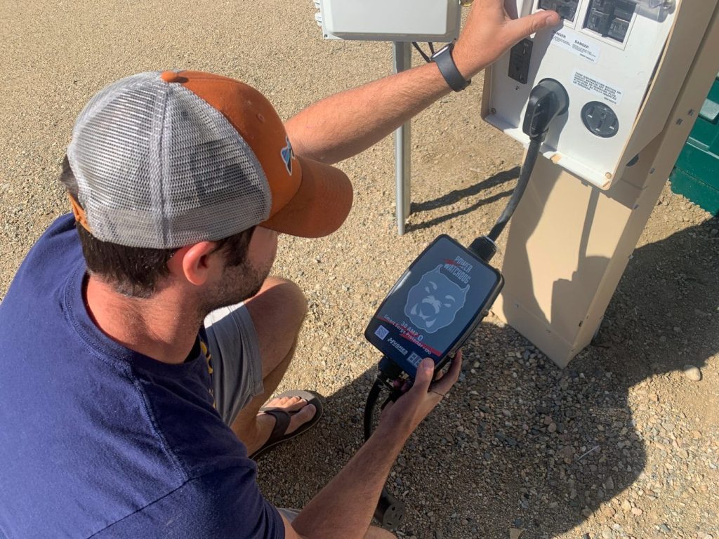

  • Check the power at the pedestal. Is the breaker on? Can you measure sufficient voltage according to the outlet’s power rating?

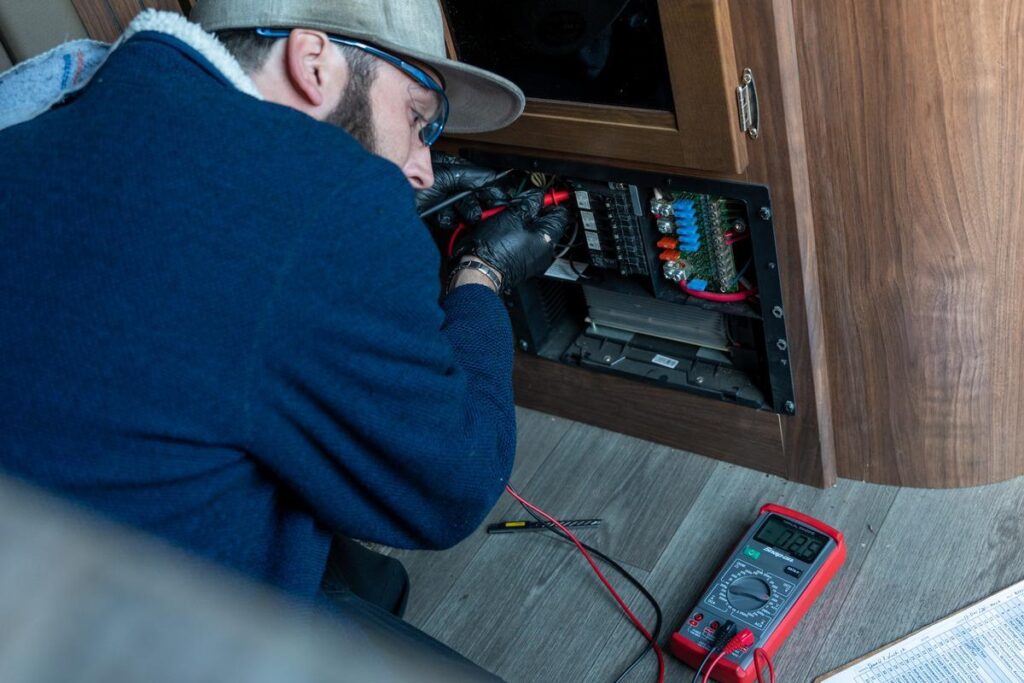

  • Check the battery voltage, clean the terminals, and ensure the battery cables are secure.
  • Check for blown fuses and/or tripped breakers.
  • Ensure the battery disconnect is on.
  • Troubleshoot issues with your RV converter.

  • Use a surge protector to guard your RV against low/high voltage, miswired pedestals, and other electrical issues.

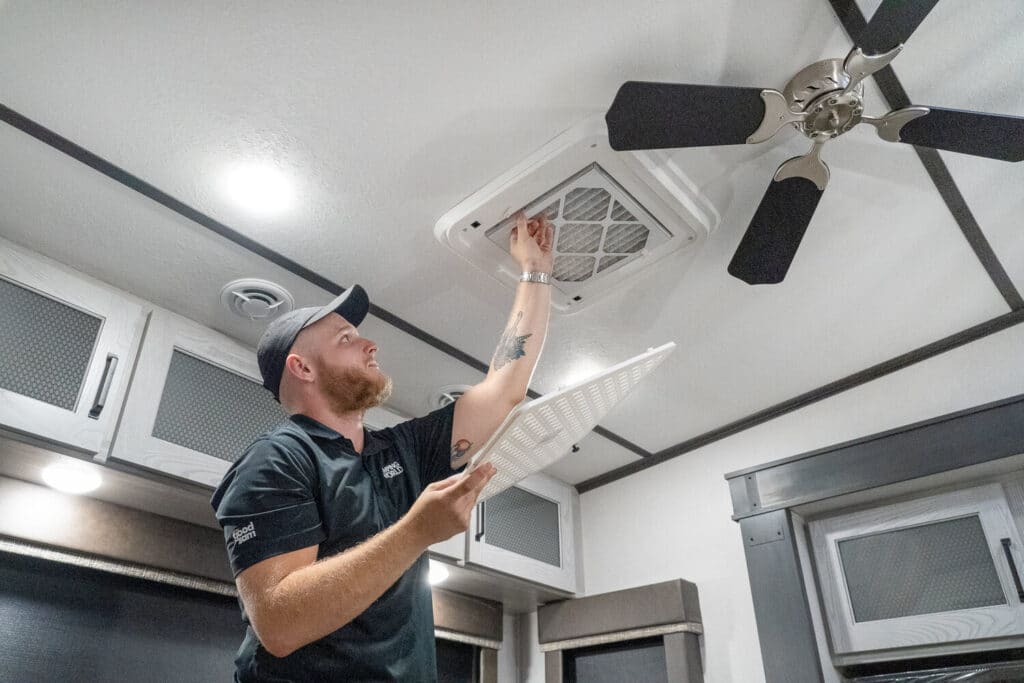

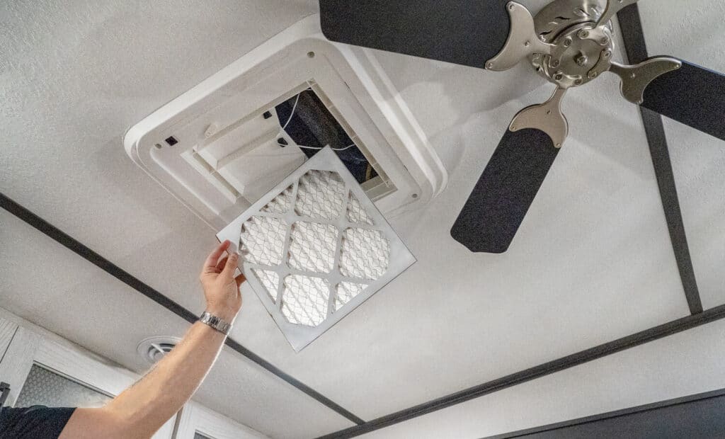

The first potential issue is a dirty or clogged filter, which can reduce airflow over the evaporator coils by as much as 50%. A dirty filter can also lead to dirty coils, reducing your air conditioner’s efficiency.
That dirty air filter can also cause evaporator coils to freeze due to a lack of airflow. Low refrigerant can also cause this issue, often due to a small leak in a factory-sealed rooftop air-conditioning unit.
Additionally, you may feel warm air from your A/C vents due to holes in the system. In ducted systems, foam or coil collars can leak or separate, which allows cold air to escape into the return air space or roof cavity before it’s directed through the ductwork and into the room. If the thermostat is set too low or the quick-cool vent is left open too long and the AC overcools the room, the AC can ice up, blocking airflow.
To go deeper, check out our step-by-step guide to fixing an RV AC that’s not cooling.

  • Clean air filters to ensure adequate airflow.
  • If you see ice on the coils above the filter, turn the A/C off for 30 minutes. Then, run the fan to ensure the coils are thawed before restarting and monitoring performance.

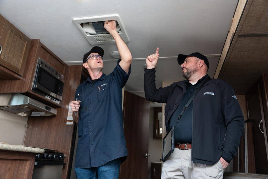

  • Remove the interior A/C cover and inspect for leaks or separations where the return air supply could be mixing with warm air. Inspect the ductwork for holes, collapsed areas, or separations that allow cold air to escape or be blocked. Use HVAC foil tape to seal problem areas.

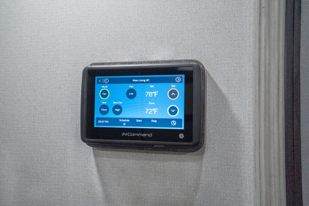

  • Maintain your RV battery monthly and replace the batteries in battery-powered AC thermostats at least twice a year.
  • Consider relocating the thermostat if it’s on an outside wall. It can also be moved if it’s positioned near a hot appliance, such as the stovetop, or in a location where an AC vent blows directly on it.
  • Redirect AC vents to ensure they are not blowing directly at the thermostat or the return air vent.

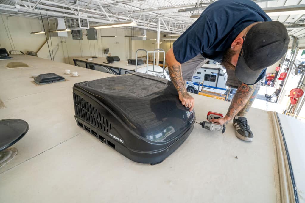

Water Drips Inside from the AC
You walk through your RV and feel water drip on your head. No, you’re not imagining things. This is an unfortunate issue that requires RV air conditioner troubleshooting, but the cause is typically one of four possibilities: a dirty or clogged filter, an impacted drain pan or line, improper installation, or a broken pump.
Ductwork leaks, separations, or impingements can also cause condensation and dripping when cold air enters the return air plenum. On some models, a worn-out or overtightened gasket presses the drain hole into the rubber roof membrane, preventing water from passing through.
Solutions:
  • Clean air filters and coils to ensure adequate airflow.
  • Inspect the drain pan and line. Remove dirt and debris that is preventing proper drainage.
  • Ensure the exterior gasket is properly aligned over the roof opening to prevent leaks.
  • Check that the compression of the exterior gasket meets the manufacturer’s recommendation—typically 50% compression.
  • Schedule an AC inspection to have the pump, gasket, drain pan, and other components professionally inspected.

  • Check/tighten mounting bolts, adhering to the manufacturer’s torque specifications. Some tighten from above, requiring the removal of the A/C shroud. Most tighten from the inside, requiring the removal of the entire ceiling assembly cover to access the bolts.
  • Ensure the fan blades aren’t rubbing against the housing and realign the set screw as needed.
  • Listen for a high-pitched squeal signaling dry motor bearings. Consult the A/C manufacturer about the proper oil type, amount, and lubrication method.
