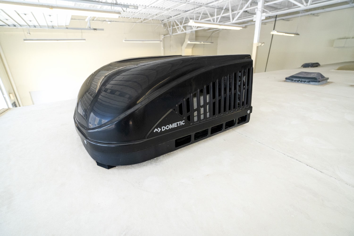

  • Inspect the shroud regularly. The shroud protects the A/C components mounted on your roof. Check it before and after each trip to ensure it isn’t cracked or missing. Cracks allow dust, moisture, and other debris to degrade sensitive A/C components.

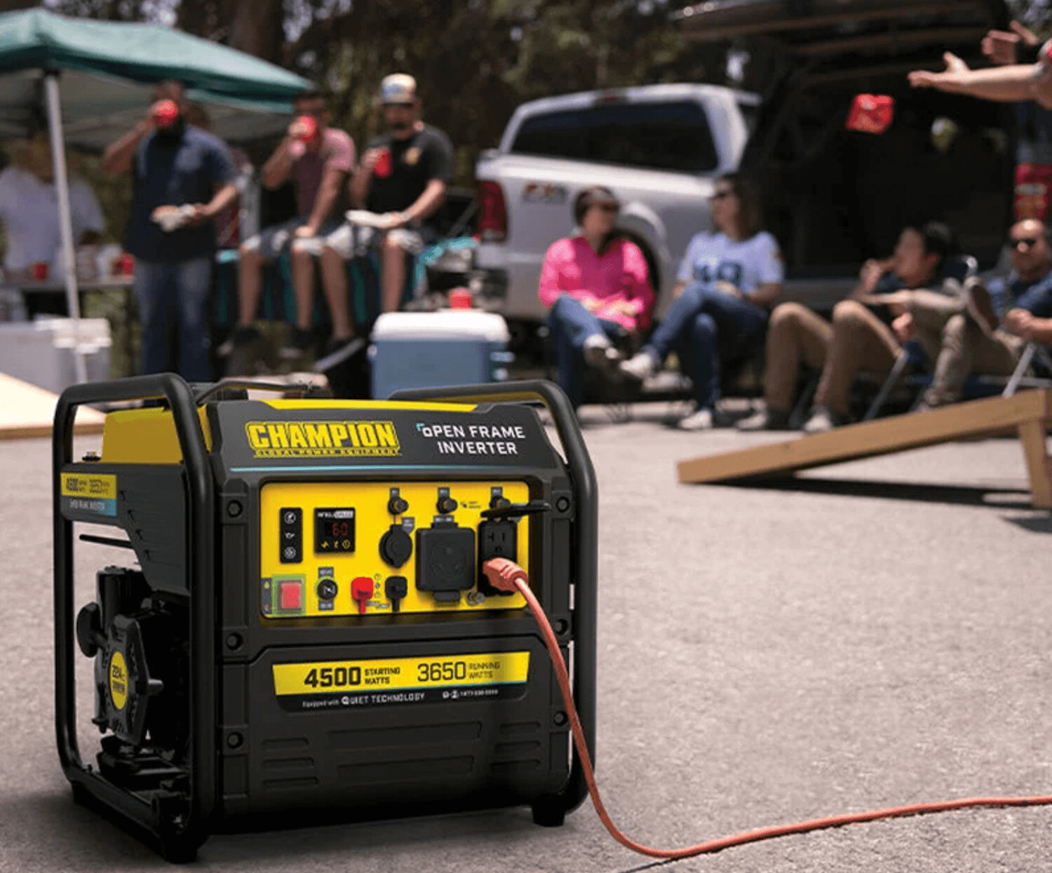

Will a 3500-watt Generator Run an RV Air Conditioner?
The short answer is yes, but larger units draw more power and may limit your ability to run other RV appliances, even with a 3500-watt generator. You’ll need to know your air conditioner’s surge and running watts.
Here are some generator size recommendations based on your RV’s electrical demands:
  • 30-Amp RVs: Minimum 3,500-watt generator
  • 50-Amp RVs: 6,000 to 8,000-watt generator for RVs with dual ACs; 10,000 to 12,500-watt generator for RVs with three ACs.
Technician Tip: Just like the 80/20 rule for towing capacity, we shouldn’t use the smallest possible generator. To maximize the generator’s fuel efficiency and minimize wear and tear, choose a generator that is about 20% larger than the minimum size. Learn more: What Size Generator Do I Need for My RV?

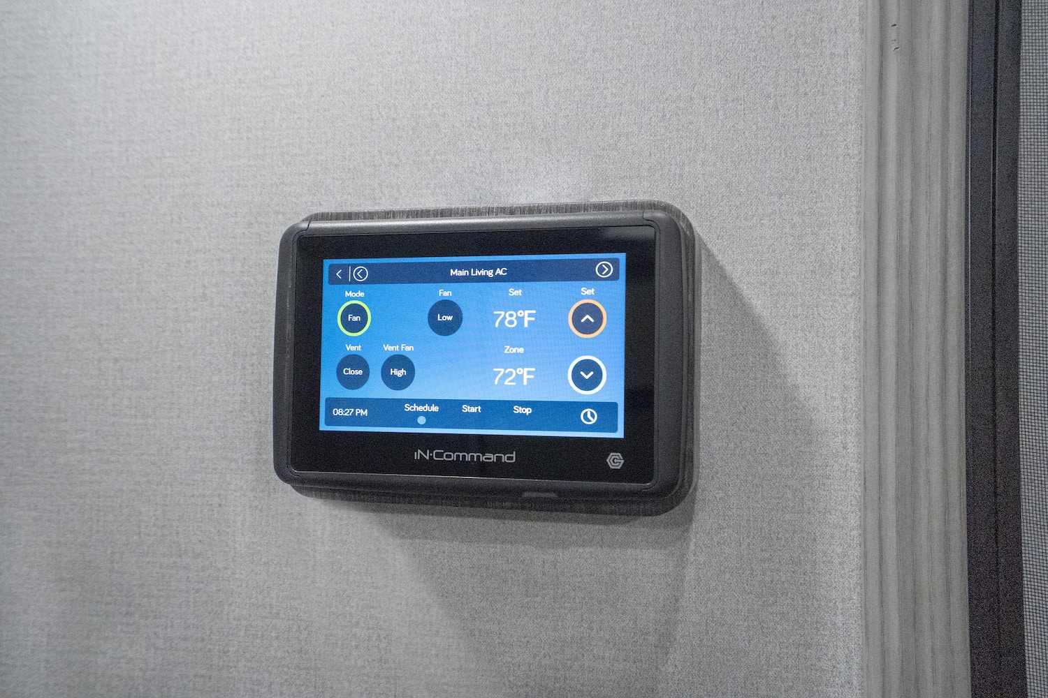

Can You Add a Thermostat to an RV Air Conditioner?
Most A/C units have a built-in thermostat or are wired to a wall-mounted thermostat in your RV. Aftermarket residential thermostats rarely work with RV air conditioners, and while upgrade kits are available, they must be from the manufacturer and be designed specifically for your AC make and model.
These kits will likely require installing additional components to communicate properly with your AC. If your thermostat needs to be replaced, your best bet is to consult the owner’s manual and wiring diagrams for your model and contact your local service center.
