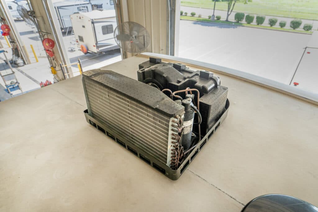

What Does the Capacitor Do in an RV Air Conditioner?
Your RV AC’s compressor needs a strong initial surge of electricity to start spinning; more than it needs to keep running once it’s up to speed. This is often called ‘surge wattage’ in an air conditioner’s specifications. The start capacitor stores and releases that surge, giving the compressor the power it needs to start.
Some air conditioners also use a run capacitor, which remains in the circuit while the compressor is operating, helping it run more efficiently. Both start and run capacitors can fail, and the symptoms often resemble those of a dying compressor, which is why this issue is commonly misdiagnosed.
Additionally, there are capacitors for the fan. These can have similar symptoms, such as a fan that doesn’t start and only hums, starts slowly, or bogs down when the wind blows against the outdoor condenser fan. As with the compressor, there may be a start or a start/run capacitor setup.

How To Test an RV AC Capacitor
This section will teach you what a proper diagnosis actually involves, but it is NOT a DIY walkthrough. Testing a capacitor accurately requires a multimeter capable of reading capacitance, knowledge of the correct microfarad (µF) rating for your specific air conditioner, and safely discharging the capacitor before ever touching its terminals. The importance of this last point can’t be overstated for your personal safety.
A certified technician will typically first confirm the AC is receiving adequate power and test to rule out a compressor issue. They will then safely discharge the capacitor, test its capacitance against the manufacturer’s rated value, and inspect for visible signs of failure, such as bulging, leaking, or a cracked case.
A capacitor that tests below its rated capacitance or shows physical damage gets replaced with an exact match for your A/C unit’s specifications. Using the wrong capacitor value can cause the compressor to run hot or fail prematurely, which can also result in serious injury or fire.

Capacitor Failure vs Compressor Failure
These two failures can look nearly identical, but they have very different price tags.
  • Capacitor failure: the compressor attempts to start (with a hum, buzz, or click) but doesn’t stay running. This is the classic capacitor signature.
  • Compressor failure: no attempt to start at all, a continuous, unusual noise from the compressor area, or a burning smell. This points toward the compressor itself, which is a more involved and expensive repair.
