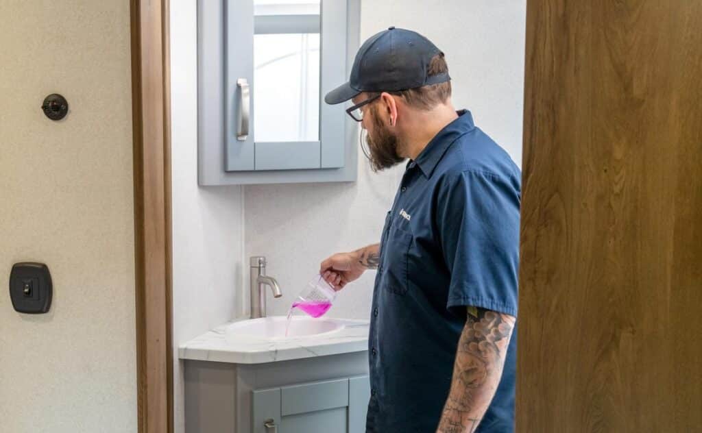

Most RV owners can successfully DIY winterize their rig, and many do it every season without issue. Using a siphoning kit to draw RV antifreeze through the plumbing system is a straightforward process once you understand your RV’s layout. With the right supplies and a couple of hours, it’s well within reach for the average owner.
That said, “can you” and “should you” are different questions. DIY winterization works for owners who know where their low-point drains are, how to properly bypass (or winterize) the water heater, and which appliances in their rig need separate attention. Owners who are less certain about any of those things are at higher risk of a missed step. And in winterization, a missed step can cost significantly more than what it would have cost to have it done professionally.

  • Using automotive antifreeze instead of RV-safe antifreeze. Automotive antifreeze is toxic and will contaminate your potable water system. Always use pink, non-toxic RV antifreeze.
  • Forgetting to bypass a tank-style water heater before adding antifreeze. Without the bypass, antifreeze fills the water heater tank, wasting several gallons and potentially leaving the actual plumbing lines unprotected. It will also damage the water heater’s anodic coating, leading to premature failure.
  • Missing low-point drains, external faucets, or outdoor showers. Every water outlet needs to run pink before you’re done. Walk the exterior of the rig systematically.
  • Not removing inline water filters before pumping antifreeze. Antifreeze can degrade certain filter media. Remove filters before winterizing, then install a fresh filter in spring after flushing.
  • Overlooking water-using appliances. An ice maker, dishwasher, washing machine, or outdoor kitchen sink each has its own water supply line that needs to be winterized.
  • Incomplete water heater drain. The anode rod needs to come out, and the pressure relief valve needs to be opened to let air in. Without both steps, residual water can remain in the tank, fittings, and/or valves.
