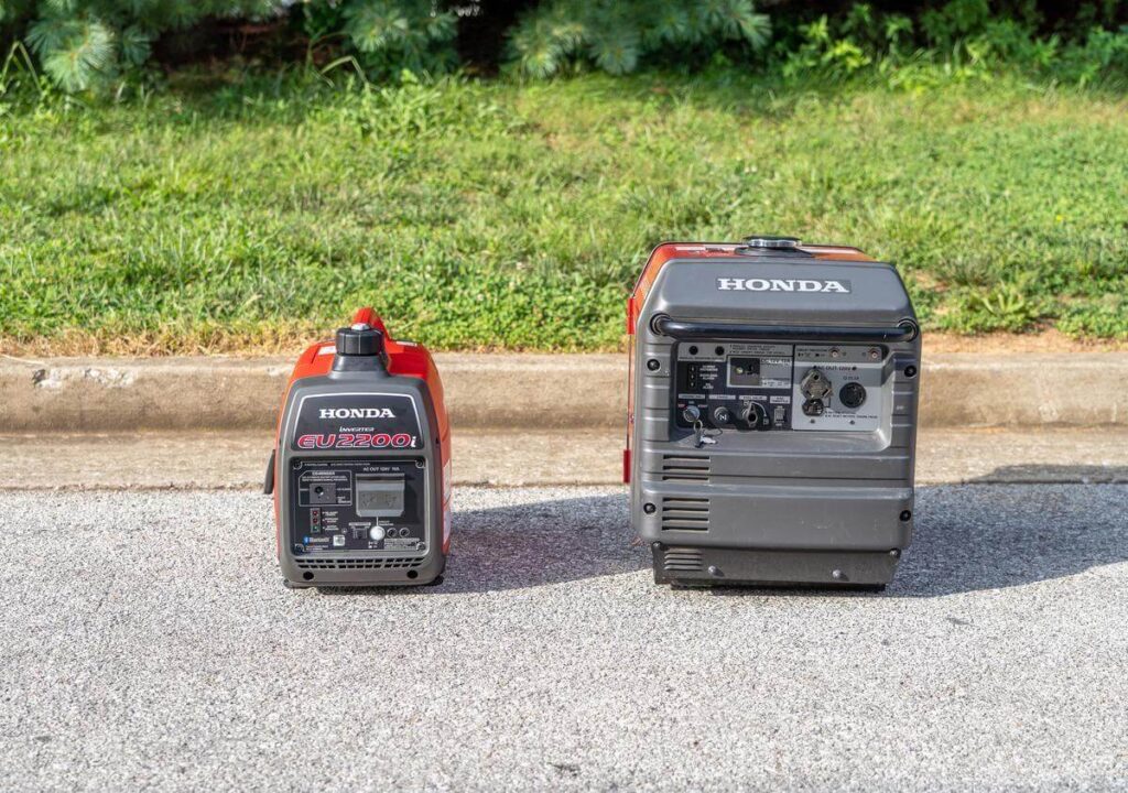

  • Portability and Size: Inverter generators are generally more compact and lightweight, making them easier to store in basement compartments, strap to an RV cargo carrier, or transport around a campsite.

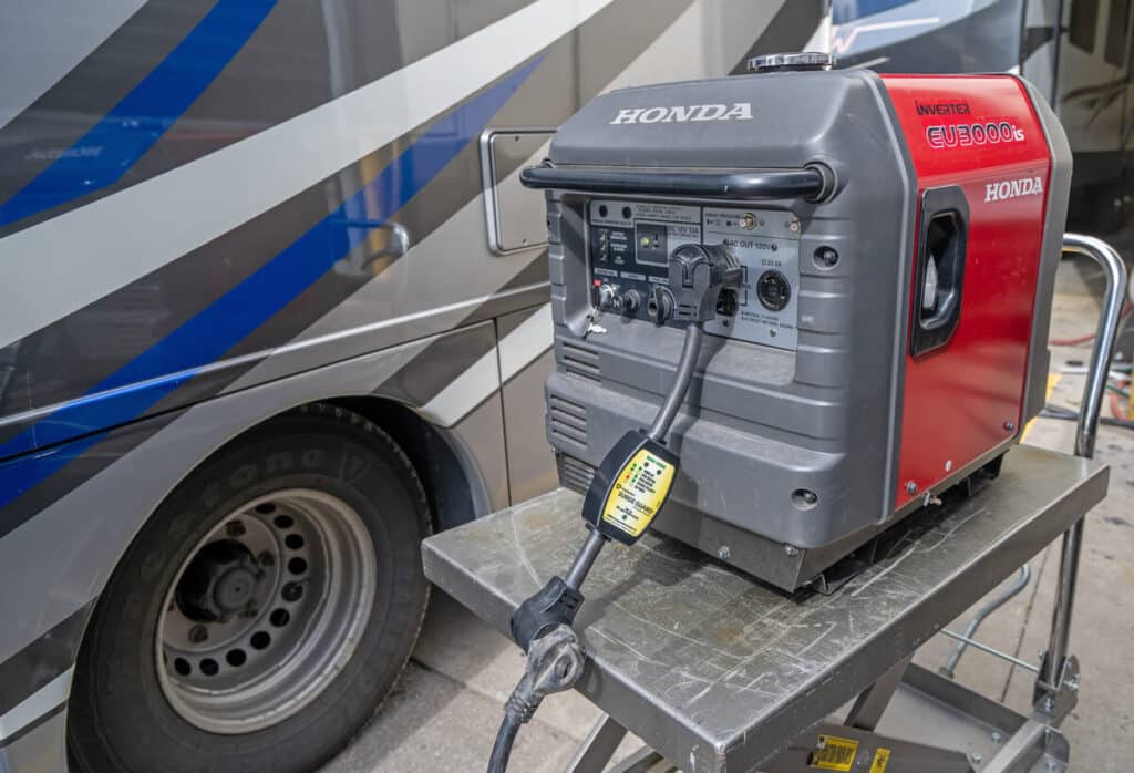

An inverter generator with RV-ready outlets — especially a 30-amp receptacle — makes setup much easier. They allow you to plug your shore power cord directly into the generator without an electrical adapter. Many RV inverter generators also include USB ports and 12V DC outlets, which are handy for charging small electronics without using your RV’s electrical system.
Proper outlet compatibility is more than just convenience — it affects performance. Using an adapter with a non-RV outlet may not allow your RV to access full generator power, which could limit the appliances you can run. Always look for an inverter generator labeled “RV ready” to ensure maximum compatibility and efficiency.

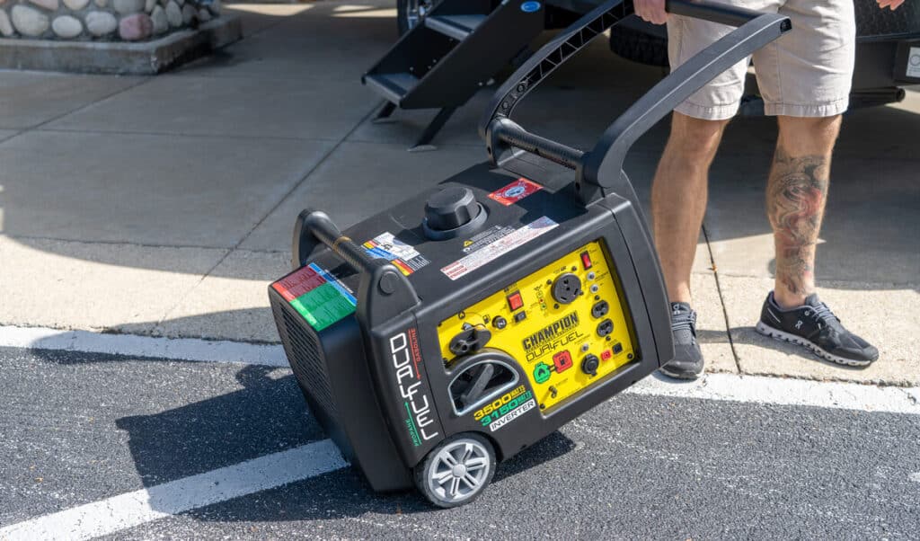

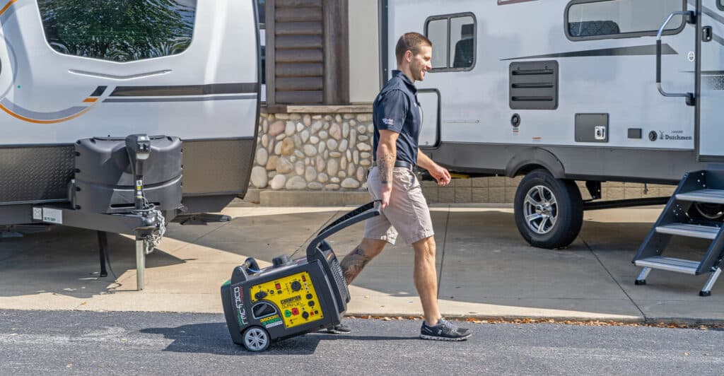

One of the most significant advantages of inverter generators is their compact, portable design. Look at the generator’s overall size, weight, and mobility features like built-in wheels or telescoping handles. If you camp in remote areas or store gear in a truck bed or RV basement, a smaller footprint and lightweight construction make a big difference.
Larger generators offer more power but tend to weigh more, sometimes over 100 pounds. If you often camp solo or want something easy to lift and reposition, consider inverter generators under 60 pounds with molded handles. The easier it is to transport, the more likely you’ll use it regularly during your travels.
