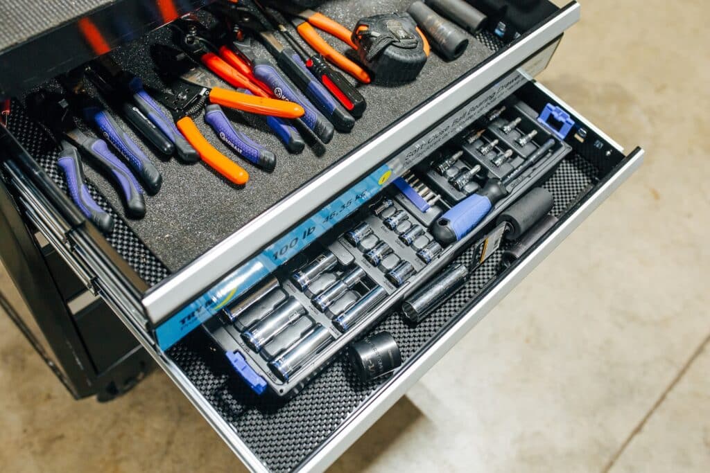

Tools Needed For Winterizing Your RV
For proper winterization, you’ll need the following tools and supplies:
  • Cordless power drill with Philips and/or #2 square bit
  • Socket wrench and socket sized for your drain plug (typically 1-1/16″, ⅞”, or 15/16”)
  • Flashlight
  • New anode rod or plastic drain plug (as required)
  • Thread tape rated for potable water
  • 3-4 gallons of RV antifreeze (extra never hurts)
  • 2 crescent wrenches or a set of open-end wrenches
  • Siphoning kit (if the pump is not already equipped)
  • Water heater bypass kit (if not already equipped)
  • Needle-nose pliers or a screwdriver

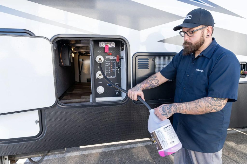

6. Add RV-Safe Antifreeze
Some RVs will require a siphoning kit to add antifreeze. These kits typically come with specific installation instructions. Others come with a siphoning hose connected to the internal plumbing. For the latter, there’s typically a valve that needs to be opened to allow the water pump to draw antifreeze into the system.
Find the right type of RV antifreeze.
With that valve open, place the siphoning hose (installed or with the kit) into your first gallon jug of antifreeze.
Turn on the water pump to draw antifreeze into the water system, and repeat this with a second gallon jug.
Starting with the closest sink to your water pump, open one of the faucets (hot or cold) until you see a steady stream of pink antifreeze exiting the fixture. Repeat with the other faucet, then continue until you’ve run antifreeze through every interior hot- and cold-water line.
Again, don’t forget the shower and toilet. At this time, you may need to add additional antifreeze, but save at least one gallon.
Head outside and open each faucet on any exterior sinks and showers until they run pink. Repeat with each of the low-point drains.
Once complete, turn off the water pump.
