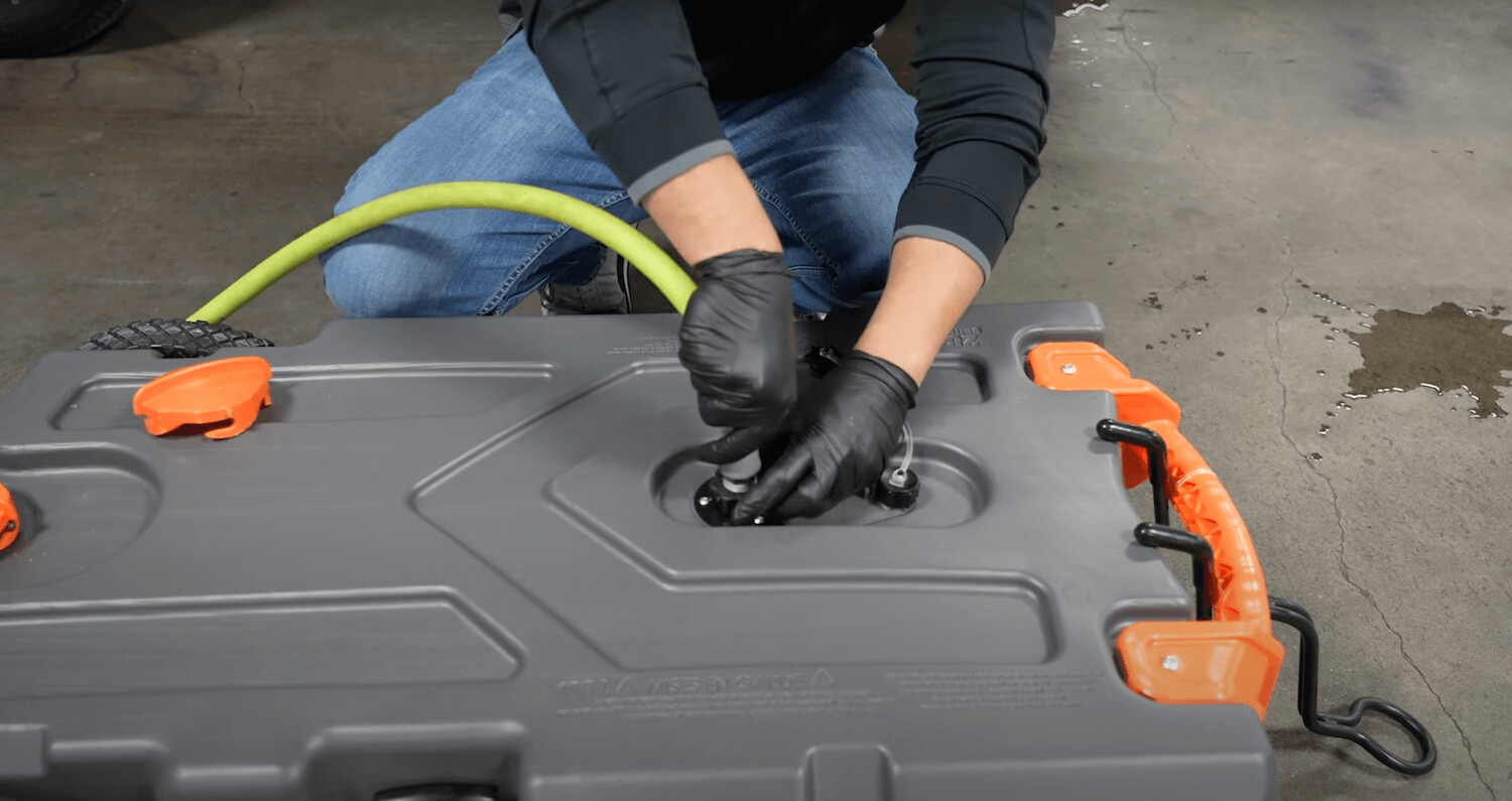

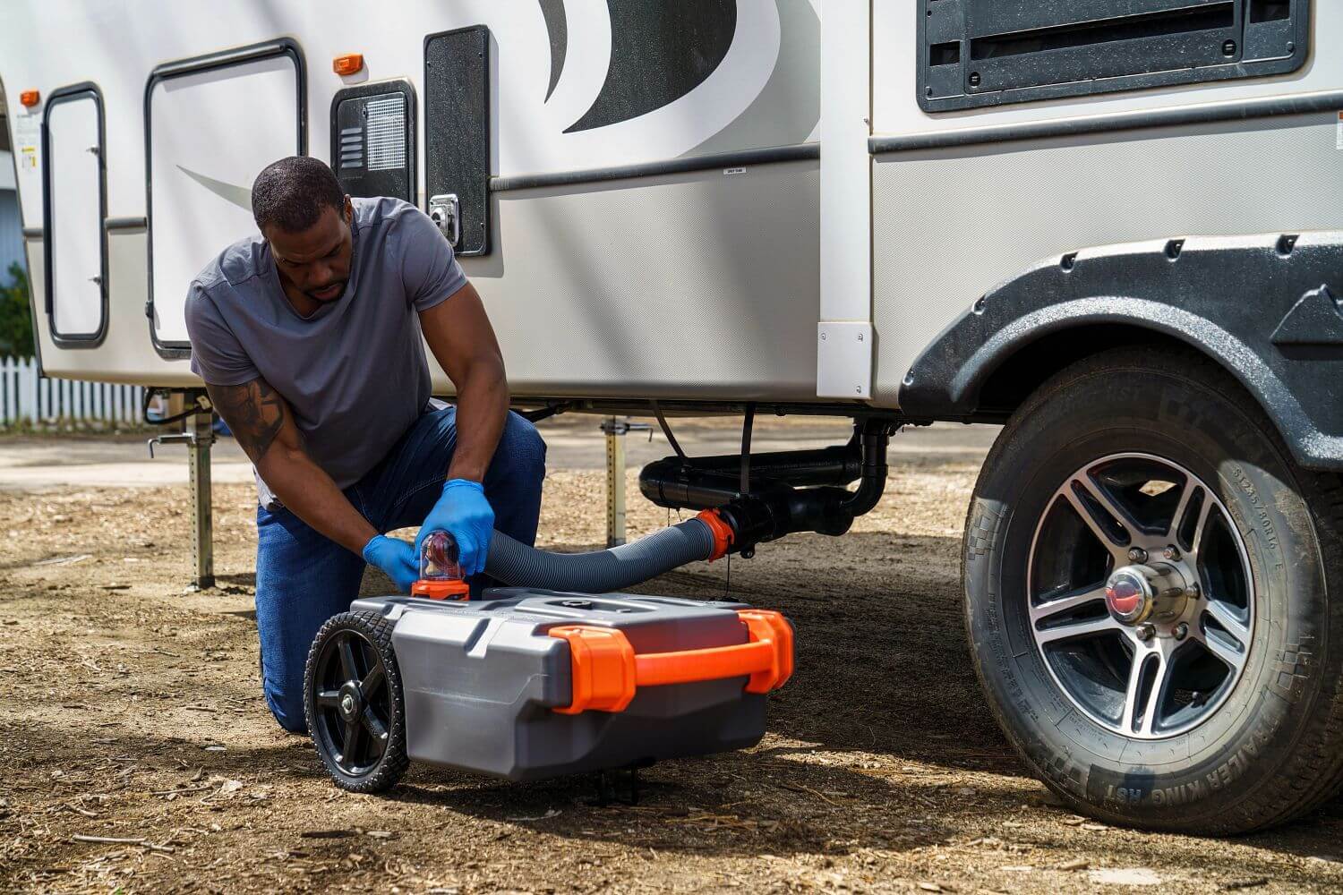

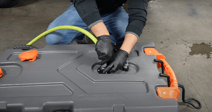

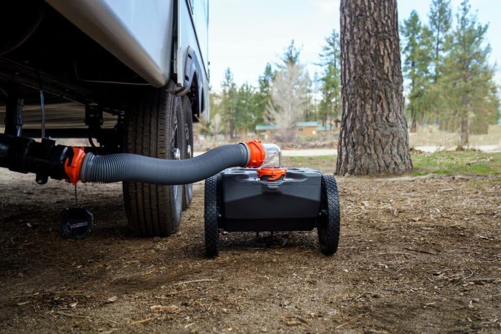

  1. Connect a 90-degree clear elbow to the fill opening on top of the tank. A clear elbow is recommended to see when the tank is close to its capacity.
  2. Attach one end of the flexible 3-foot sewer hose to the clear elbow and the other to the termination outlet for your RV holding tanks.
  3. Open the portable waste tank’s vent and empty your holding tanks into your waste tote the same way you’d empty them at a dump station – black water first, then gray water.
  4. Close your holding tank gate valves and screw the portable waste tank’s vent shut before detaching the sewer hose from the tank termination outlet. Cap the outlet before proceeding.

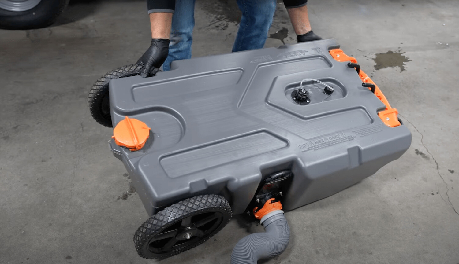

Detach the sewer hose completely and cap both openings (on your RV and the portable tank). Cap the 3-foot sewer hose before transporting it, and the tank, to the dump station.
For portable sewer tanks with two 3-inch openings:
If your tank has two three-inch openings, the top opening is your tank fill, and the side opening is for dumping the tank. Connect the detached end of the sewer hose to the dump opening on the side and leave the clear elbow and the other end of the hose connected to the fill opening.

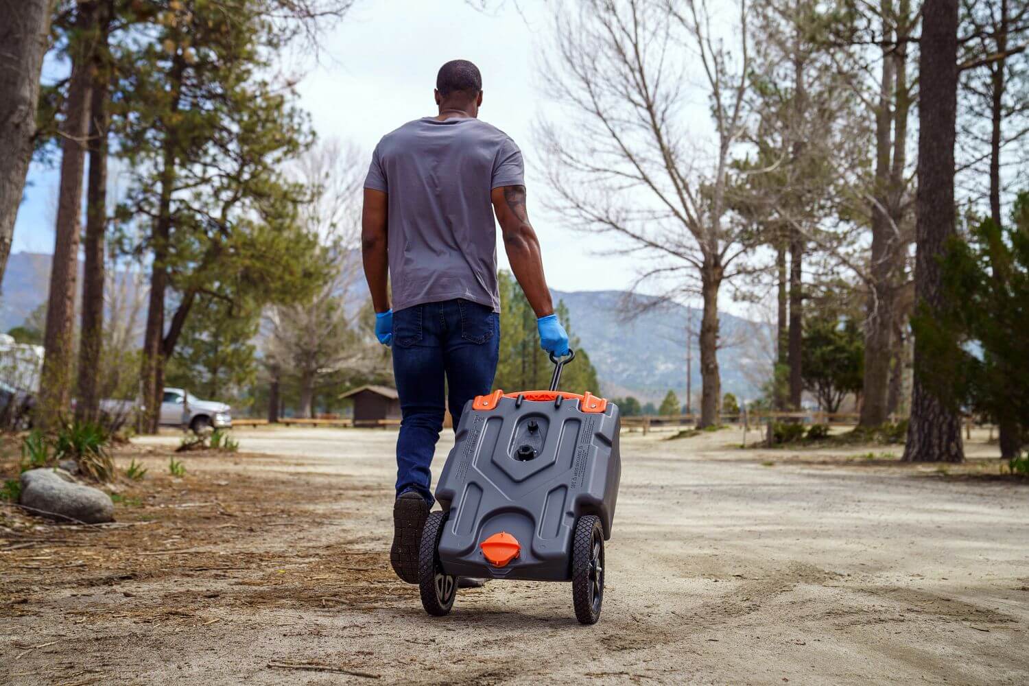

Most portable RV waste tanks can be rolled to the dump station by hand, depending on their weight. The tow adapter comes in handy as an extension for the front carry handle.
For heavier tanks or longer trips, the tow adapter also slips over a tow hitch, allowing you to pull the RV sewer caddy to the dump station. This should always be done only at slow speeds – a recommended max of 5 MPH.
If you must travel a longer distance, carefully secure your portable sewer tank in an open truck bed so it doesn’t move during transit.
