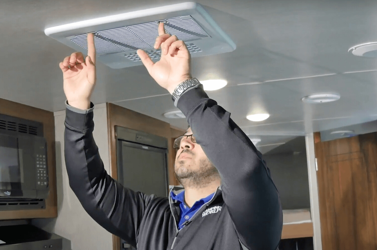

Inspect and Clean The Air Filter
This is the easiest and most important step for AC maintenance. Find your air filter under a removable panel on your AC’s air distribution box. Consult your owner’s manual if you’re having trouble locating it. Most owners should remove, inspect, and clean the AC air filter quarterly (every 3-4 months). If you’re a full-time RVer, increase that frequency to monthly.
When cleaning, you can simply use warm water to rinse the dust and other contaminants from your filter. Vigorous scrubbing shouldn’t be required, but you may gently use a sponge and mild detergent to remove pesky residue. Allow your filter to dry completely before putting it back into the distribution box.
When inspecting, you’re looking for any holes or tears that would compromise the filter’s ability to catch contaminants. Holes or tears are a sign that it’s time for an AC filter replacement.

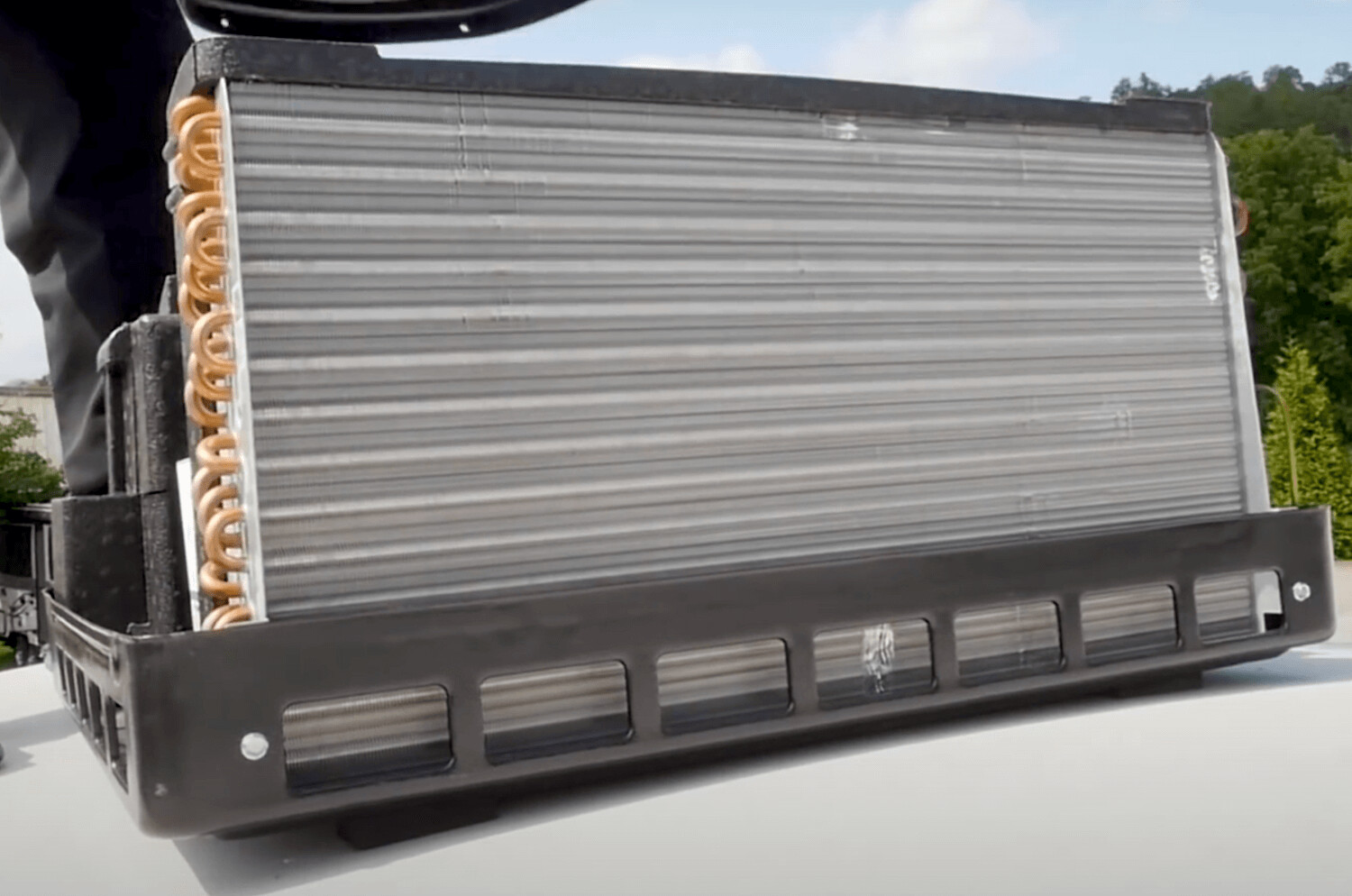

Only the manufacturer’s intended filter should be used. Aftermarket or residential filters may cause the AC to malfunction. While your filter is out, clean the evaporator coil fins above it. Dust and pet hair build up here, too, and a dirty coil reduces airflow just like a dirty filter does.
A soft brush attachment on a vacuum works well for loose dust. For coils on Dometic® units specifically, avoid high-pressure water or harsh chemical cleaners. A gentle, non-corrosive coil cleaner is safer for the fins and won’t risk bending them.

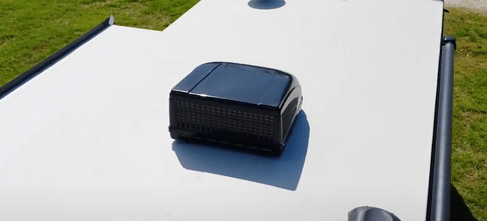

Inspect The Shroud

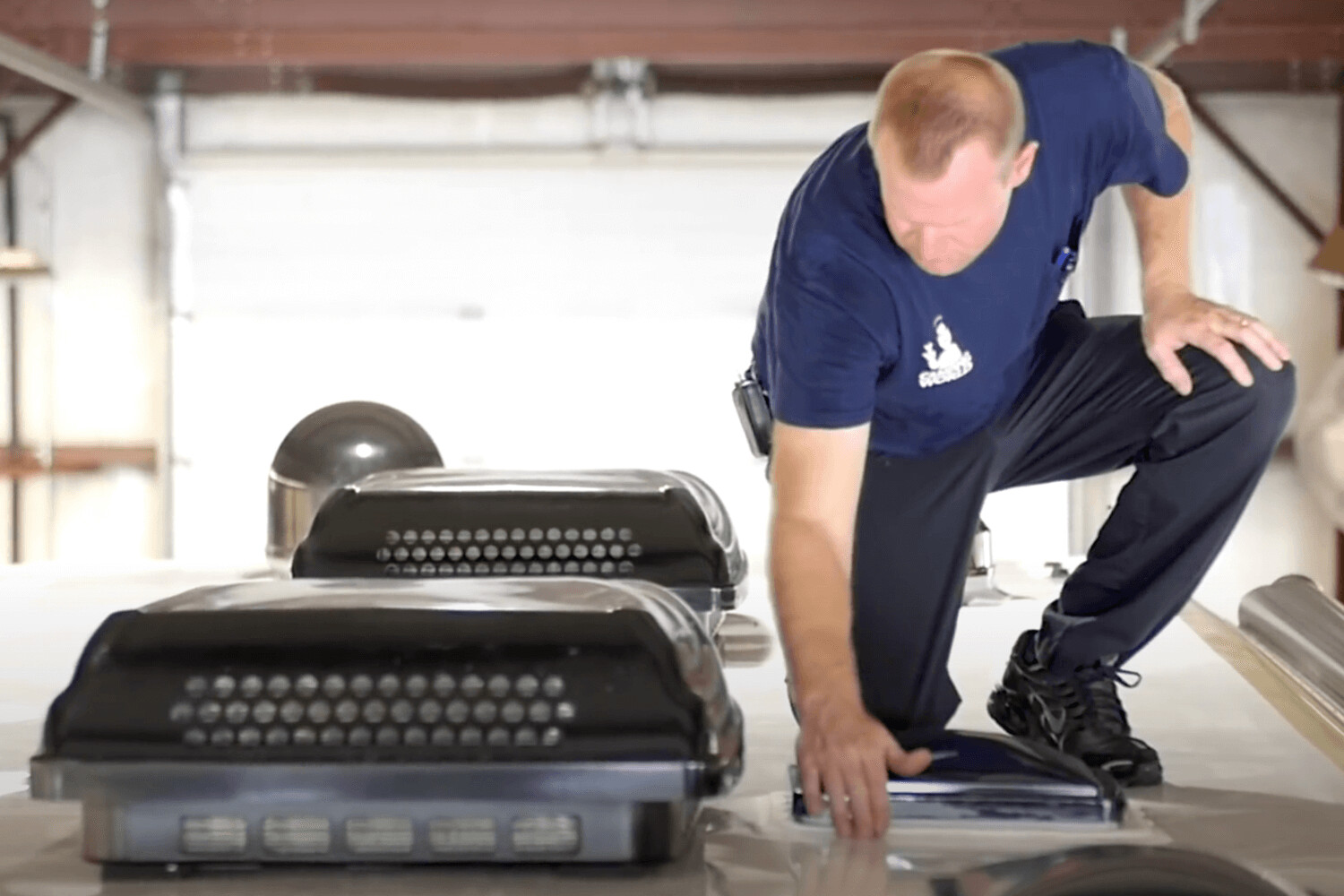

At least annually, you’ll need to safely climb onto the roof to check the shroud. Park on level ground and confirm your ladder is stable and rated for your weight. Check your owner’s manual to see whether your roof is rated as walkable. Some RV roofs are not designed to support a person’s weight directly.
Once safely on the roof, look for large cracks or missing chunks that could allow moisture and debris to enter. These should signal that it’s time for a shroud replacement if it isn’t adequately protecting the system underneath. This will help you avoid more expensive repairs down the line.
Also, use a flashlight through the shroud’s vent openings to inspect the components underneath for signs of nesting activity, physical damage, or overheated components or wiring. When storing your RV for long periods, it’s best to use an air conditioner cover to protect the shroud from moisture and UV exposure.
Technician Tip: It’s smart to check the A/C, rubber roof membrane, and all appurtenances from the roof or a step ladder every time you reach your destination. You can’t be too cautious with this one, and damage often occurs while traveling. If that damage goes unnoticed and unrepaired, it can allow for water infiltration from dew, rain, or air conditioner condensation
