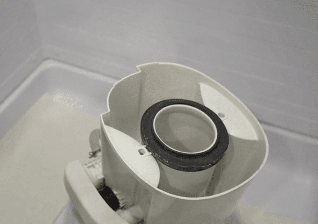

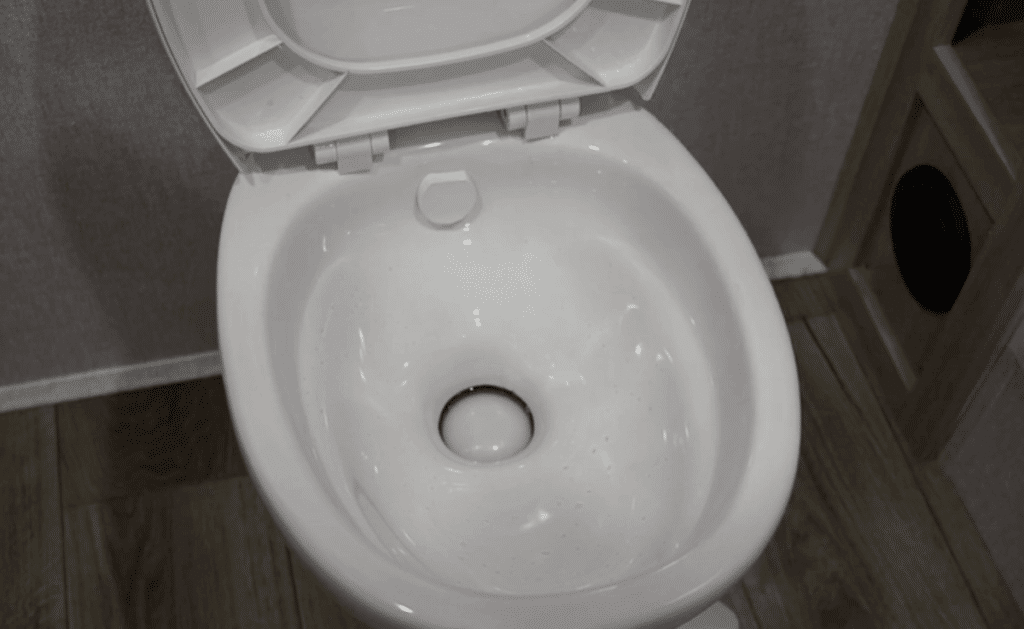

RV Toilet Won’t Hold Water (Bad Seal or Ball Valve)
When the bowl won’t retain water, the most common failure point is the flush ball seal. Over time, those rubber seals dry out, crack, or accumulate debris, preventing a full and watertight seal. You’ll usually notice the bowl slowly draining after filling, with the water level refusing to stay above the ball valve, a faint hiss or bubbling around the seal, or a foot pedal that doesn’t allow the ball to fully close—classic signs that the seal is worn or dirty.
How To Fix an RV Toilet Seal
Follow these steps to remedy the issue:
  1. Turn off the water supply to the toilet.
  2. Press the foot pedal to open the ball valve.
  3. Clean the seal with a soft brush and mild cleaner to remove buildup.
  4. Apply a toilet seal lubricant and conditioner to re-lubricate the seal.
  5. If the leak persists, replace the seal entirely.
Use these guides to replace a flush ball seal in these common RV toilet brands:

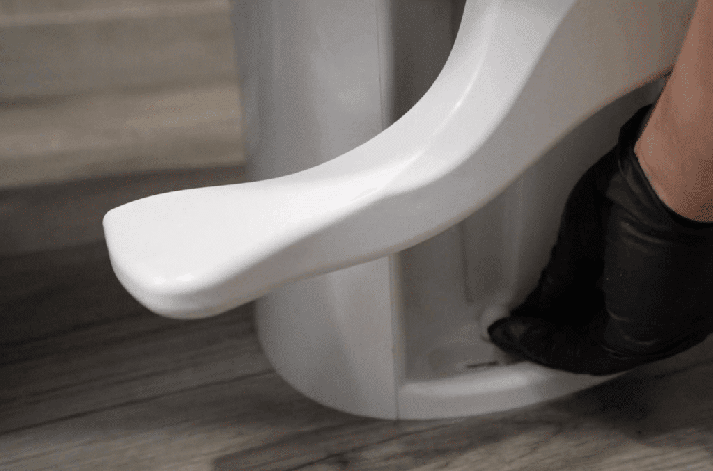

RV Toilet Foot Pedal Doesn’t Work or Feels Stiff
If flushing feels crunchy, sticky, or doesn’t activate water flow, the foot pedal linkage may be damaged or disconnected.
How To Fix an RV Toilet Foot Pedal
  1. Shut off the water to the toilet.
  2. Remove the shroud around the toilet base (usually a few screws).
  3. Inspect for broken springs, rods, or plastic connectors.
  4. Lubricate hinges and moving parts.
  5. Replace broken parts or swap the entire pedal assembly if necessary.
Technician Tip: You may need to contact the toilet manufacturer directly for replacement parts.

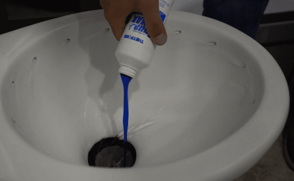

  • Open the ball valve and pour 5-10 gallons of hot (not boiling) water—mixed with a quart of tank chemical to dissolve built-up solids—down the toilet. Let it sit 8–12 hours.
  • Add ice + water, drive around, and let the movement break the debris loose.
  • Treat the tank with the same RV-safe tank treatments you normally use.
  • Use your built-in black tank flush or a flexible tank wand if needed.

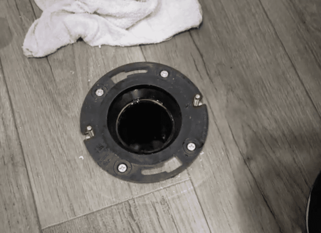

RV Toilet Leaks at the Base or Underneath
A leaky RV toilet often points to a failed flange seal, loose mounting bolts, or cracks in the base. Some leaks are more noticeable than others, ranging from occasional drips around the base to steady moisture pooling on the floor or a persistent musty smell that shows water is escaping somewhere it shouldn’t.
How To Fix a Leaking RV Toilet
  1. Shut off the water and drain the bowl.
  2. Disconnect the water line from the back of the toilet.
  3. Loosen mounting bolts at the base—carefully to avoid cracking.
  4. Remove the toilet base.
  5. Inspect the flange seal for flattening or cracks.
  6. Replace the seal if water continues escaping. Ensure you use a compatible replacement seal for your toilet model.
  7. Check the water line fittings for drips.
Consult our RV toilet flange seal replacement guide for further assistance.
Toilet Wobbles or Shifts While Sitting on It
A rocking RV toilet almost always means the floor flange bolts are loose or the base gasket is worn out.
How To Fix a Wobbly RV Toilet
  1. Turn off the water and disconnect the supply line.
  2. Loosen the toilet base and lift the toilet to expose the floor flange.
  3. Remove bolt caps and tighten hardware evenly until snug. Avoid overtightening, as it can crack the floor flange.
  4. Test for wobbling. If fixed, re-anchor the toilet and reconnect the water.
  5. Remove the toilet and replace the foam or rubber base gasket if rocking persists.
