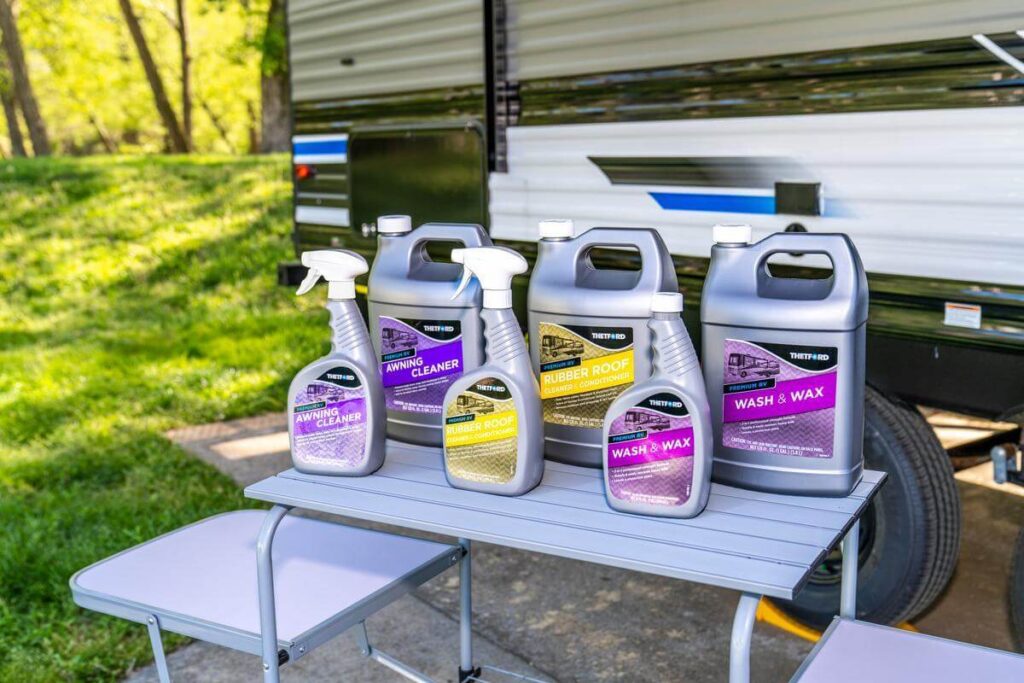

What Cleaning Products Are Safe For Your RV?
The safest answer is always to follow your RV manufacturer’s recommended cleaning products and guidelines, as different RV exterior materials (fiberglass vs aluminum vs rubber roofing, etc.) require different care. That said, here are general rules that apply to most RVs:
  • Use pH-neutral, non-abrasive soaps for exterior washing to protect your RV’s finish and decals.
  • Avoid bleach on rubber roofs — it accelerates degradation. Use a dedicated rubber roof cleaner instead.
  • For black and gray water tanks, enzyme-based tank treatments are safer for seals and sensors than bleach-based products.
  • For interior surfaces, look for non-abrasive, RV-safe multi-surface cleaners. Harsh chemicals can damage cabinetry finishes, upholstery, and countertops.
  • For disinfecting, use EPA-registered products proven to kill germs on contact on hard surfaces.

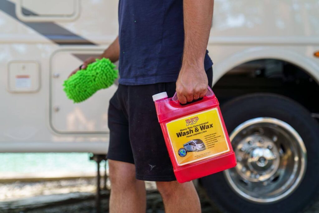

How To Clean Your RV Exterior and Roof
Washing an RV after every trip prevents black streaks, fading, and other unsightly issues. Here’s a quick RV exterior cleaning guide:
Use RV-safe cleaning products and wash your RV’s entire exterior from top to bottom, working in sections. Start with the roof, then the rear cap, the camp-side wall, the front cap, and then the off-camp wall. Don’t forget the windows on each wall, the tires and rims, and propane bottles (if they aren’t enclosed), which may all require specialized cleaning products, per your RV manufacturer’s recommendations.
Here are a few additional tips for washing the outside of your RV:
  • Allow RV awnings and slide toppers to dry completely before clothing and latching them securely to prevent moisture penetration and retention.
  • Consider waxing your RV exterior every 3-6 months to prevent UV damage and oxidation. Consult the manufacturer for recommended waxing products.
  • Use a squeegee to dry RV windows and prevent streaking.
  • Dry each section with a gentle, microfiber towel as you go for a more spot-free finish.
Regular post-trip washing and waxing prevent bug buildup, grime, and mold from baking on while your camper is in storage.
Technician Tip: As you’re washing your RV, note dents, missing sealant, and other exterior damage to create a checklist for offseason maintenance. Don’t forget to empty storage compartments and clean camping accessories, such as chairs, patio mats, and grills, to prevent mold and rust.

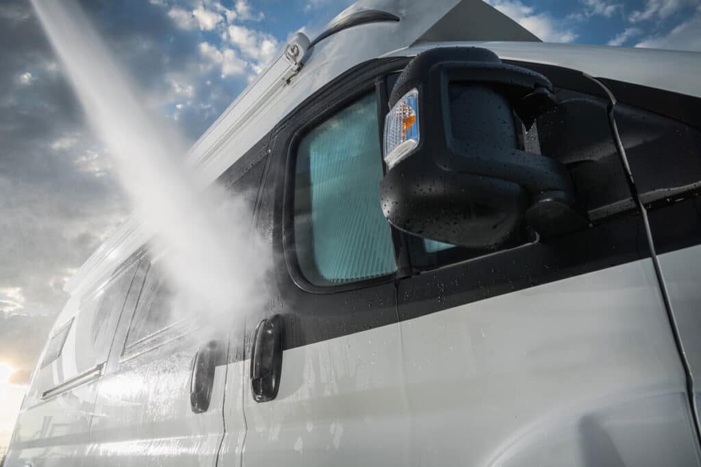

Can You Pressure Wash an RV?
Image by welcomia via iStock
Pressure washing is a common question for RV owners, and the short answer is: with caution. A standard residential pressure washer on a low setting can be used on an RV’s exterior, but high pressure can damage decals, seals, paint, gelcoat, roof membranes, and other exterior components. You may also find portable pressure washers for RV cleaning, but the same cautions apply.
Always keep the spray wand moving — never hold it in one spot — and avoid directing water at windows, vents, or any seams and sealants. For the roof, a gentle garden hose rinse or a soft brush is usually safer than a pressure washer.
When in doubt, consult your RV’s owner’s manual or ask a service technician at your nearest Camping World Service Center.
