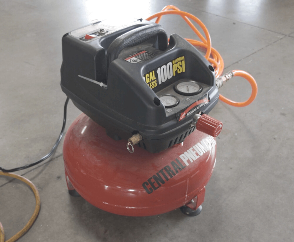

- Air compressor

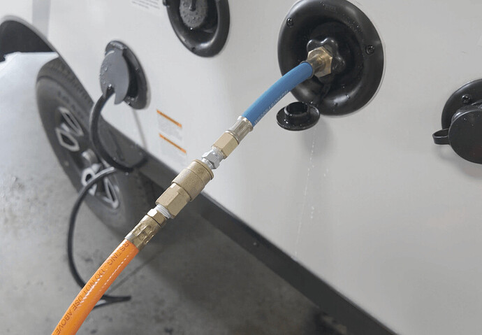

- Blow-out hose or plug

The safe recommended pressure for blowing out RV water lines is between 30 and 40 PSI, depending on your water heater’s make and model. The maximum recommended pressure for RV water lines is roughly 60 PSI. To avoid damage to the plumbing lines, your compressor must not exceed that pressure.

4. Connect the compressor to your RV’s city water inlet using the blow-out hose or plug. If using a blow-out hose with a valve, ensure it’s in the open position to allow air into the lines.
5. Set the compressor to a low-pressure setting (between 30 and 40 PSI) and turn it on.
