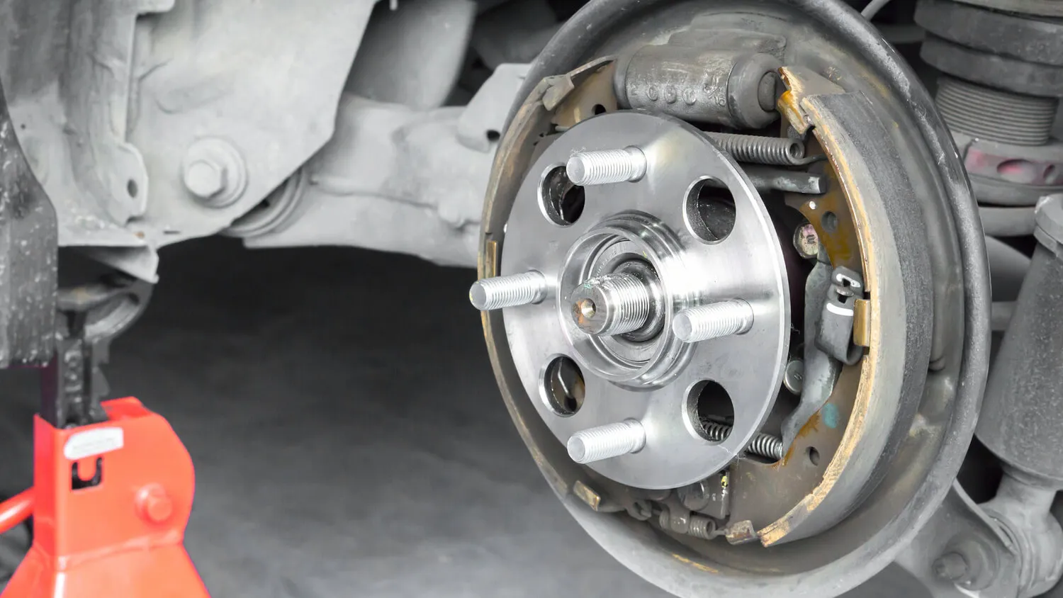

Your wheel bearings are located inside the hub of your RV wheels. They are a set of small steel rollers in a metal ring (called a cage) that allow the wheels to spin with minimal friction.

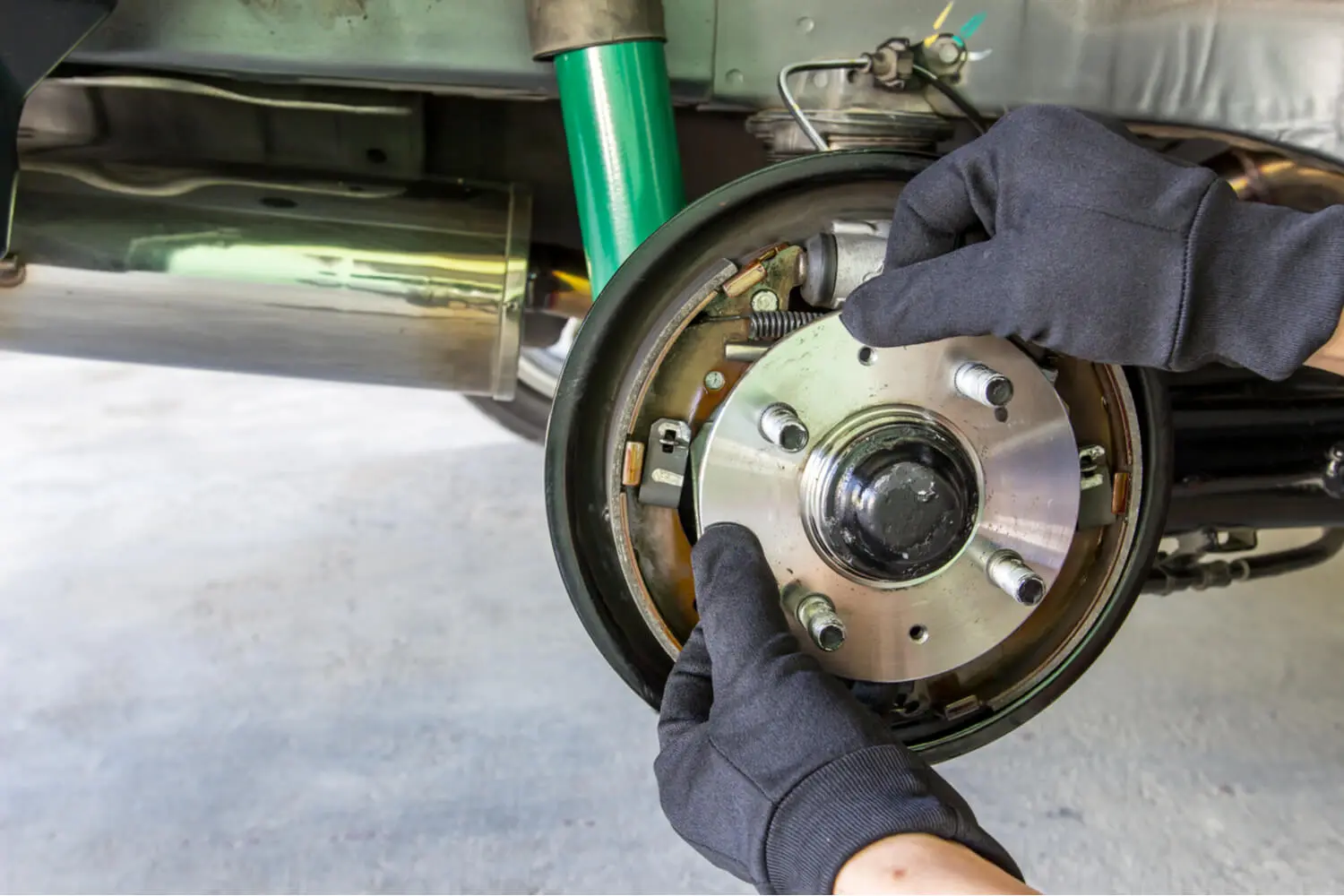

This is the most common question RVers ask. While you should always start by referring to your specific RV manufacturer’s specifications, there is a general industry standard for travel trailers and motorhomes.

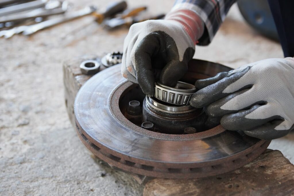

Sticking to your RV manufacturer’s recommended service intervals is the best way to stay safe, but you can also stay vigilant for these common warning signs of camper wheel bearing failure.
