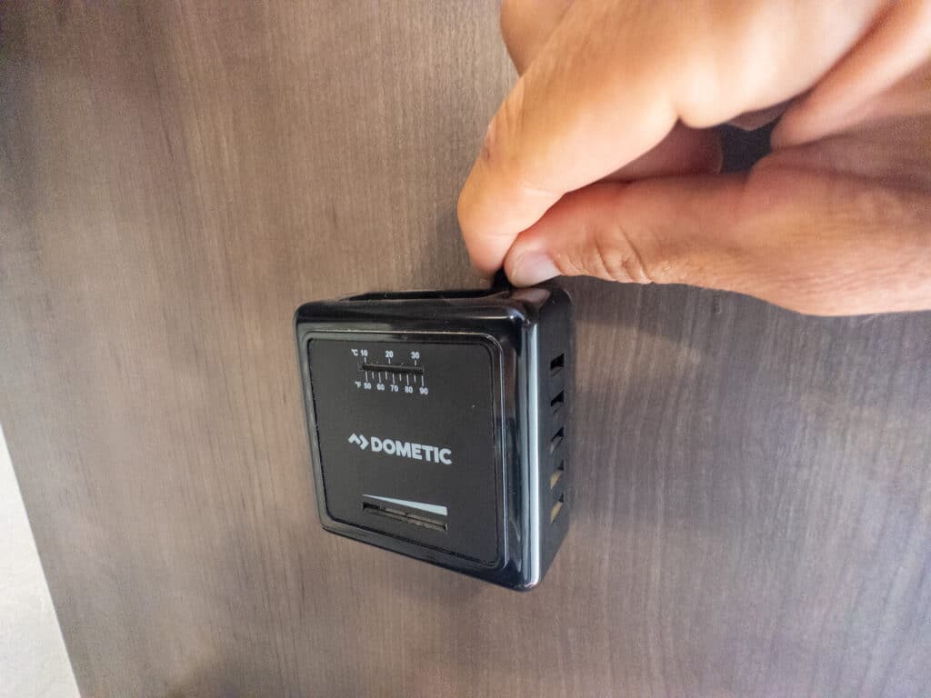

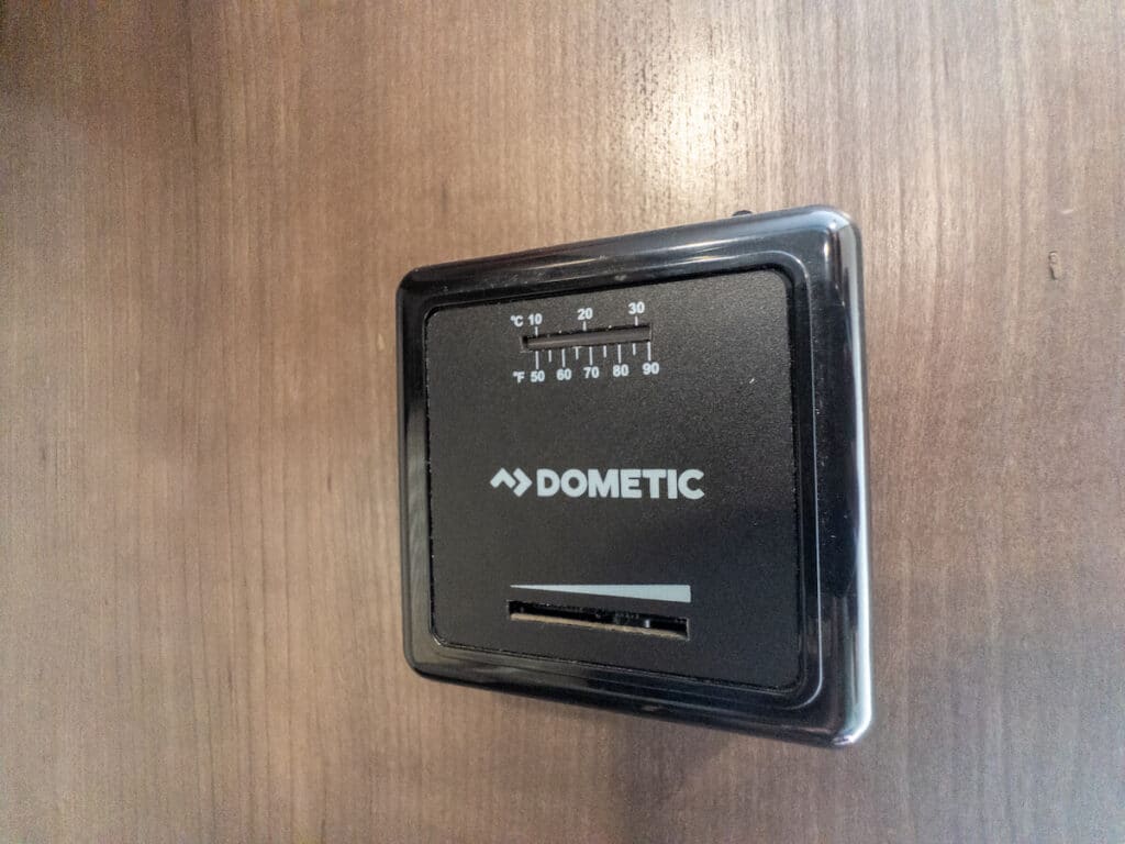

  • Analog — The simplest, most cost-effective to replace. They utilize a heat-sensitive metal that bends when the temperature rises or falls.

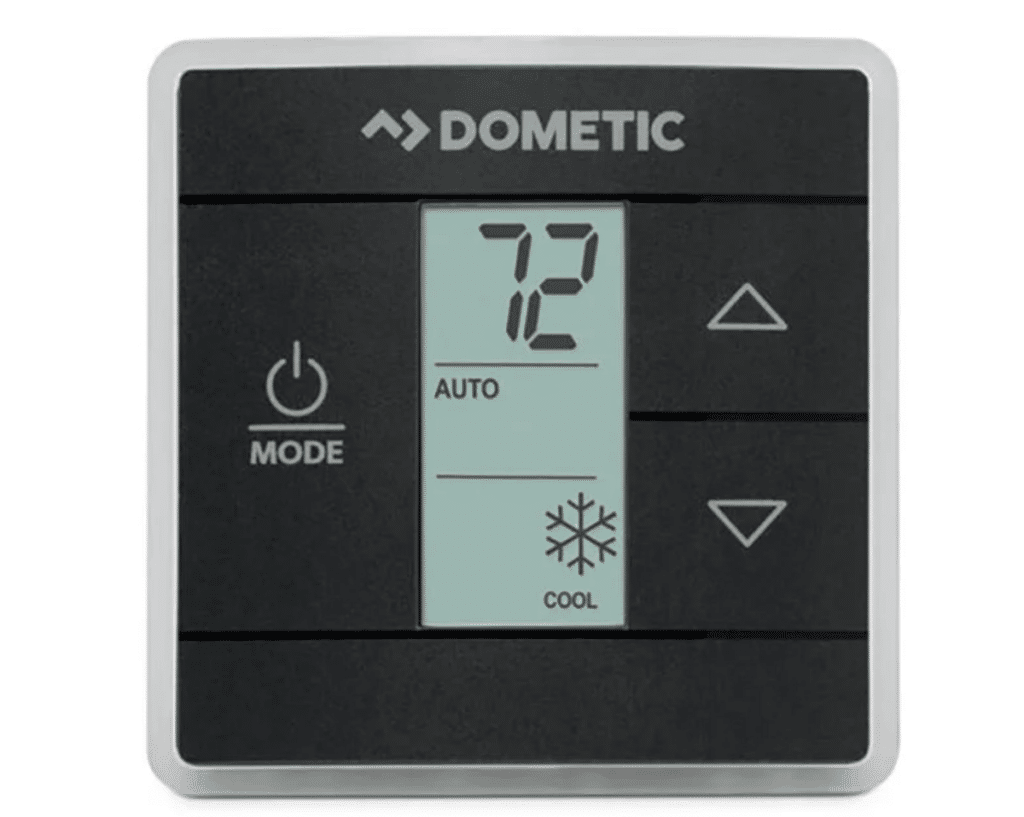

Dometic® Standard Single Zone Thermostat
Type: Digital
This Dometic® thermostat is best for smaller campers with a single cooling zone. It’s compatible with ducted and non-ducted rooftop air conditioners. It features optional Bluetooth® technology, allowing you to operate it remotely from the Dometic® app on your Apple or Android device.

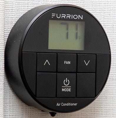

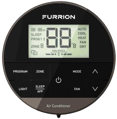

Furrion® Chill Enhanced Single Zone A/C Thermostat
Type: Digital
This Furrion® thermostat pairs a clean digital display with straightforward controls, making it a solid single-zone option for smaller RVs. It offers two fan speeds, an auto fan mode to hold your set temperature, and a dry mode to help manage humidity. The backlit LCD display stays easy to read in low light.

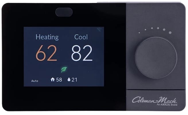

Coleman Mach® Wi-Fi Thermostat
Type: Smart, Digital
This smart Coleman Mach® RV thermostat connects to a Wi-Fi network and gives you three modes, plus access to local weather, humidity, and interior temperature. It’s compatible with most Coleman Mach® air conditioners and heat pumps, making it a natural upgrade. When you’re away from the RV, the app lets you monitor and adjust your climate control settings as long as both your handheld device and the RV are connected to Wi-Fi.

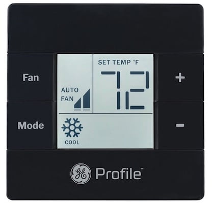

GE® RV Single Zone Wall Thermostat
Type: Digital
This GE® thermostat gives you precise control over a single-zone RV air conditioning system, with a sleek black design that fits most RV interiors. It’s built for reliable day-to-day operation and easy installation, making it a solid choice if you want a dependable single-zone replacement without smart features.
Furrion® Chill Enhanced Multi-Zone A/C Thermostat
Built for RVs with multiple cooling zones, this Furrion® thermostat adds Bluetooth® app control to its multi-zone capability. You can adjust each zone from your phone in addition to the soft-touch display. It offers three fan speeds, an auto fan mode, and a sleep mode for quieter nighttime operation, and it’s compatible with Furrion® Chill rooftop AC units, multi-zone controllers, and air distribution boxes.

How To Tell If Your Dometic® Thermostat Is Bad
Dometic® RV thermostats show up in everything from entry-level travel trailers to high-end motorhomes. They can fail in a way that’s easy to mistake for a bigger problem: the display looks completely normal, but the signal that tells the compressor to actually start cooling never gets sent. The fan runs, the air stays warm, and nothing you adjust on the thermostat seems to change anything.
A few signs point specifically to the thermostat rather than the AC unit:
  • The display shows a set temperature and appears to respond to button presses, but the compressor never engages.
  • The thermostat works fine in one mode (like fan-only) but not another (like cooling).
  • On Comfort Control Center (CCC2) models, the display shows an error code instead of a normal temperature reading. Check your Dometic® manual or support app for the meaning of the specific code.
If you’re troubleshooting a Dometic® AC that won’t cool, it’s worth ruling out the thermostat before assuming the compressor has failed. The thermostat is a much less expensive fix.
