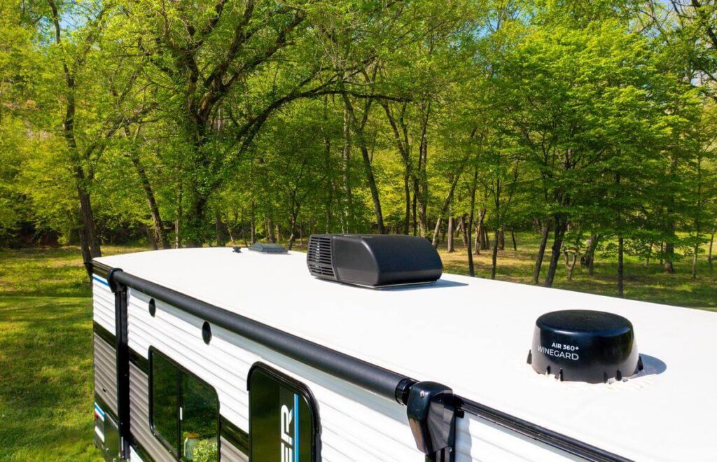

Step 1: Inspect Your Roof, Seals, and Slide-Out Gaskets
The single most important summer prep step you can take is a thorough roof inspection, and it should happen before your first major trip of the season.
Whether your RV roof is fully walkable or not, you need to visually inspect it from front to back. Use a ladder if it isn’t!
What you’re looking for: cracks or gaps in the sealant around roof vents, the air conditioning unit, any antennas, and the seams where the roof meets the sidewalls. Even a small crack in the caulking can let water in. Water damage is slow, silent, and expensive — a quick inspection and a tube of RV roof sealant costs almost nothing compared to the alternative.
Technician Tip: Do your roof inspection right after the first significant summer rain. A wet interior ceiling, a soft spot underfoot, or water pooling near a vent tells you more than any dry visual scan ever could.
While you’re up there, inspect the A/C shroud for cracks or missing chunks, and check that the gasket between the A/C unit and the roof is still compressed to roughly 50%. A compromised shroud lets moisture and debris into the cooling system — problems that compound quickly during peak use.
Also, check your slide-out gaskets and door seals. The rubber seals around the slide rooms are among the most common places where water sneaks in. Run your hand along each seal, looking for dry, cracked, or torn sections.
And once you’re safely back on the ground, inspect all exterior compartment latches and door seals — summer heat accelerates rubber degradation, and seals that looked fine in March may not look fine in June.

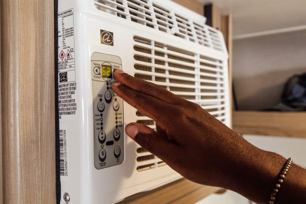

Step 2: Test Your Air Conditioning System (Before You Need It)
An air conditioner that fails on the first 95-degree night of the trip is one of the most common — and most avoidable — RV summer disasters. The time to find out your A/C has a problem is at home, not at the campground.
Start with the filter. Clean your A/C’s air filter before your first summer trip, and plan to clean it again every 4 to 6 weeks during peak-use season. Locate the filter (check your owner’s manual if needed), rinse it with warm water, and let it dry completely before reinstalling. A clogged filter restricts airflow, forces the unit to work harder, and, in severe cases, causes the coils to ice over and drip water into your RV.
Next, run your A/C on a warm day — not just for a few minutes, but for a sustained 30-minute test. You’re listening for unusual sounds (grinding, rattling, or a compressor that cycles on and off too quickly), watching for water dripping from the ceiling assembly, and confirming the unit is actually cooling the interior, not just circulating warm air.
If you notice your camper A/C leaking water inside, or the unit seems to be struggling to hold temperature, schedule a diagnostic before your trips begin. RV air conditioning service books up fast in summer — the earlier you call, the better.
Technician Tip: Summer heat means your A/C will run harder and longer than at any other time of year. Help it out by parking in shaded sites where possible, using window coverings to block direct sun, and avoiding cooking steam-heavy meals inside. A well-maintained unit can still run efficiently on the hottest days if it’s not fighting a sauna.

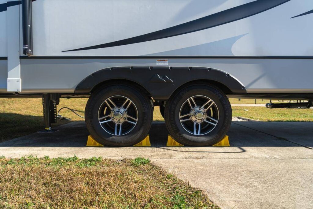

Step 3: Perform a Thorough Tire Inspection
Tires are the foundation of every RV trip, and summer is the season when tire failures are most likely to happen. Hot pavement raises tire temperatures significantly, and if your tire pressure is already low, you’ve seen visual signs of UV cracking, or they’re just past their service life, the combination of heat and highway speed is exactly the scenario that causes blowouts.
Before any summer trip, check tire pressure in the morning before the sun warms up the tires — that’s the most accurate reading you’ll get. Refer to your owner’s manual or the tire placard on your RV for the correct cold-inflation pressure, not the number printed on the tire sidewall. Tires naturally lose pressure over time, so they’re often low after storage.
While you’re checking pressure, inspect each tire’s sidewall for UV cracking — those fine cracks that appear from sun exposure and age. If you see significant sidewall cracking, the tires need to be replaced regardless of the tread depth. Most RV tire manufacturers recommend replacement every 5 to 7 years, and many suggest that even earlier if you camp frequently. Don’t let a “good-looking” tread depth convince you an old tire is road-ready.
Also check that your lug nuts are properly torqued and that all RV tires — including the spare — are accounted for and serviceable. If you have a tire pressure monitoring system (TPMS), confirm it’s reading correctly on all positions before you leave.
Technician Tip: Re-check your tire pressure after the first hour of driving on your initial summer trip. Pressure will rise as tires heat up, and an already borderline tire can quickly become a problem.

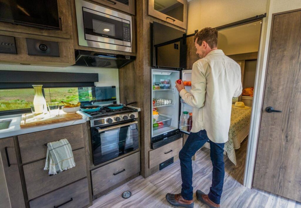

Step 5: Test All Appliances — Especially the Refrigerator
An RV refrigerator that doesn’t cool properly is a food safety issue and a frustrating mid-trip discovery. Run your refrigerator for at least 24 hours to make sure it cools adequately before summer trips. This is especially important if your fridge has been sitting unused, depending on the type of refrigerator.
For example, absorption refrigerators take longer to reach operating temperature than residential or 12V units, and that lag is even more pronounced in hot summer weather.
While the fridge is running, test your other appliances systematically:
  • Stovetop and oven: Light all burners and confirm a steady, consistent flame on each. If you have a propane oven, confirm its ignition and holding temperature.
  • Microwave: Run it for 30 seconds with a cup of water.
  • Water heater: Confirm it’s heating properly, and check the area around the access panel for any propane smell or soot (soot around the burner indicates incomplete combustion and should be inspected by a technician).
  • Generator (if equipped): Run it under load — with an appliance or two operating — for 30 to 60 minutes to keep the internal components lubricated and confirm it’s putting out clean, stable power.

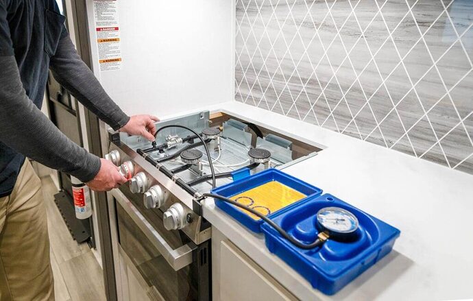

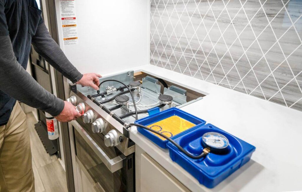

Beyond these checks, your LP gas and electrical systems should be professionally tested before each season. Leaks in a propane system are dangerous, and these tests require specialized tools that aren’t practical for DIY. Camping World Service Centers offer these inspections — and scheduling early in the season means you’re not competing with the summer rush for a service appointment.

For summer prep specifically, a few professional inspections are worth prioritizing:
  • LP gas pressure test: Verifies that your propane system is operating safely and without leaks.
