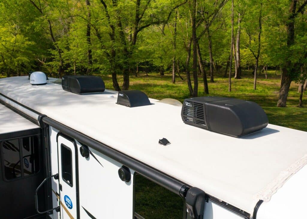

RV Roof Air Conditioners
The most popular, and for good reason, RV roof air conditioners don’t take up any space inside the RV. They are the most effective at distributing air, especially in a ducted system. These units provide the most efficient cooling, and many can also deliver heat if you have a model with a heat pump or strip. Although leading the charts in performance, they also lead the charts in power draw and replacement cost.
ProsCons
PowerfulExpensive to Replace
Don’t Take Up Interior SpaceLarge Power Draw
Heat Pump OptionAdds to Overall RV Height

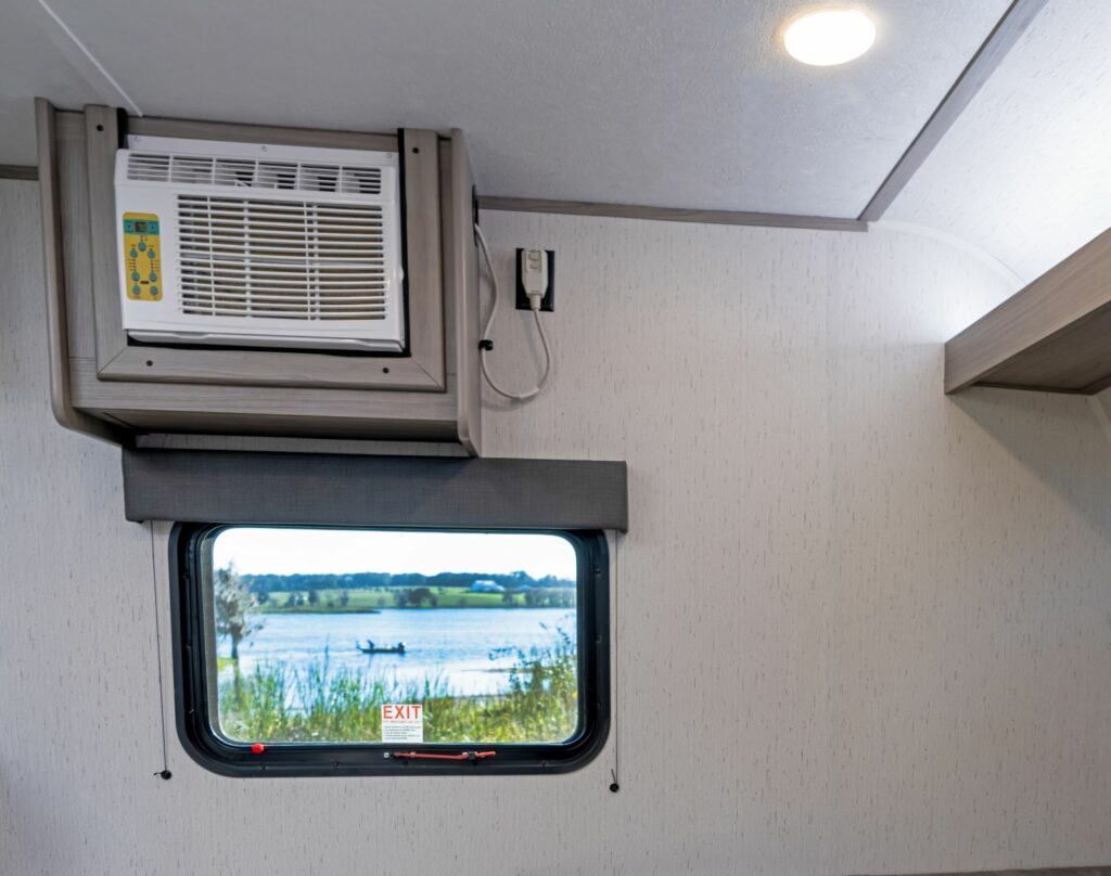

RV Window A/C Units
One issue with using an overhead air conditioner on a small camper is the potential to freeze you. Most manufacturers consider a small RV air conditioner to be 13,500 BTU, which is too much for a small RV, even on the lowest setting. With a smaller RV, you also likely have a more limited power supply, and window units draw about half as much power as an overhead A/C, on average.
ProsCons
Won’t Freeze You OutTakes Up Wall Space
Smaller Power DemandUnsightly
No Addition to RV HeightLess Efficient Cooling

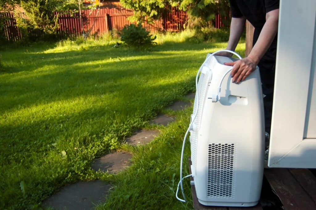

A portable air conditioner is most likely used in an RV to supplement a roof or wall-mounted unit. Its downsides include reduced cooling capacity, added setup time, and reduced storage space. However, it also has positives, such as quiet operation and less strain on your wallet.
Portable air conditioners are also an option for RVs without an air conditioner or a temporary A/C replacement. The best part is that adding one does not require significant modifications, like cutting into the roof or walls.

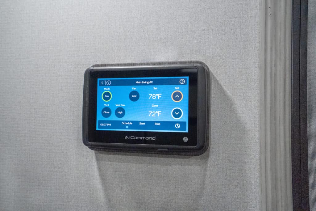

A manual system is controlled via the distribution box, so you must adjust settings directly on the ceiling or wall-mounted RV air conditioner. This may pose an issue if you’re shorter or have a high ceiling.
An electric system uses a wall-mounted thermostat for operation. Although most prefer a wall thermostat, manual systems are easier to install because you don’t have to run wires through the walls and ceiling.

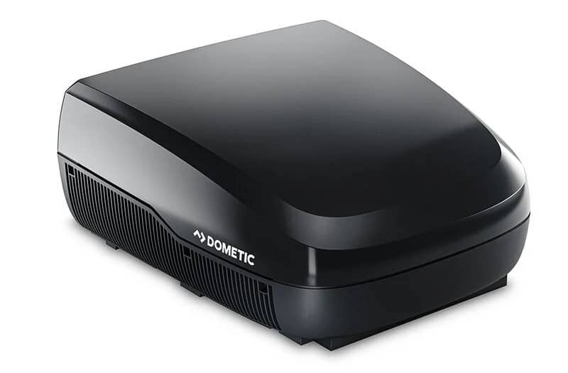

Dometic FreshJet 3 Series RV Air Conditioner
The most innovative rooftop air conditioner on the list is a Dometic RV air conditioner, the FreshJet 3. The FreshJet offers upgraded efficiency, quieter operation, and e-coated coils for added durability.
Profile Height (in.)Weight (lbs)Rating (BTUs)
13.8”64-6613,500 or 15,000

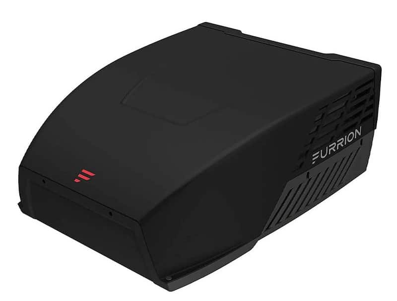

Furrion Chill HE RV Roof Air Conditioner
The Furrion Chill is a highly efficient rooftop air conditioner with durable features like vibration protection and a thermal-insulated shroud.
13.5”82-9313,500 or 15,000

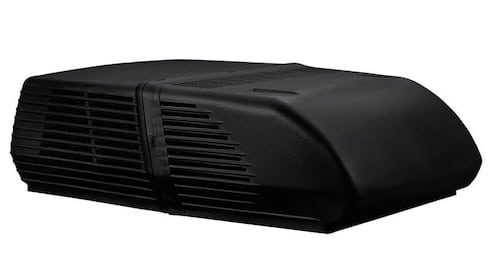

Coleman Mach Quiet Series 15 Air Conditioner
The Coleman Mach is one of the most tried-and-true RV rooftop air conditioners. This high-performance air conditioner offers superior cooling and unrivaled durability.
13.8”83.515,000

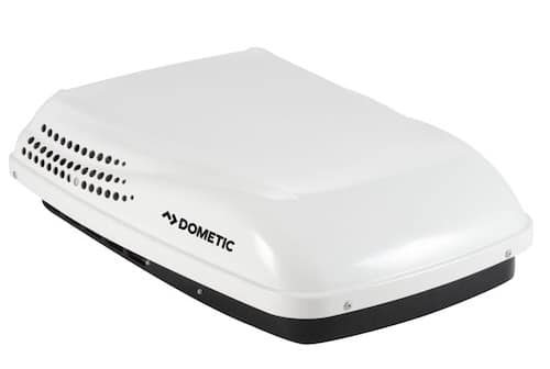

Dometic Penguin II High-Capacity Air Conditioner
What’s unique about the Penguin is its low-profile design, which improves aerodynamics and helps cut down on fuel costs. Pair this with a high-performance motor for maximum cooling power, and you have an excellent rooftop RV air conditioner.
11.25”10113,500

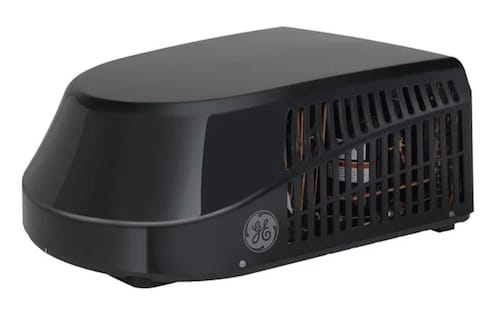

GE R32 Deluxe RV Air Conditioner
The GE air conditioner is cost-effective and reliable. It has rubber grommets to reduce vibrations, a glossy shroud to increase aesthetics, and easy-to-maintain coils for cleaning.
13.9”8013,500

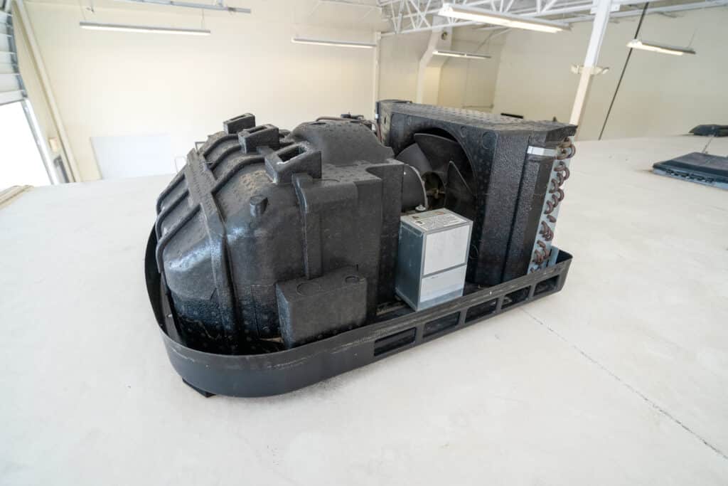

What Are the Different Rooftop Air Conditioner Components?
RV roof air conditioning systems are a collection of components that work together to deliver cool air throughout your camper. The main element is your roof-mounted unit, followed by the distribution box, a control module, and the thermostat. Some units come as a kit with all the needed items, whereas others require you to purchase them separately. Here’s how each component in the system functions:

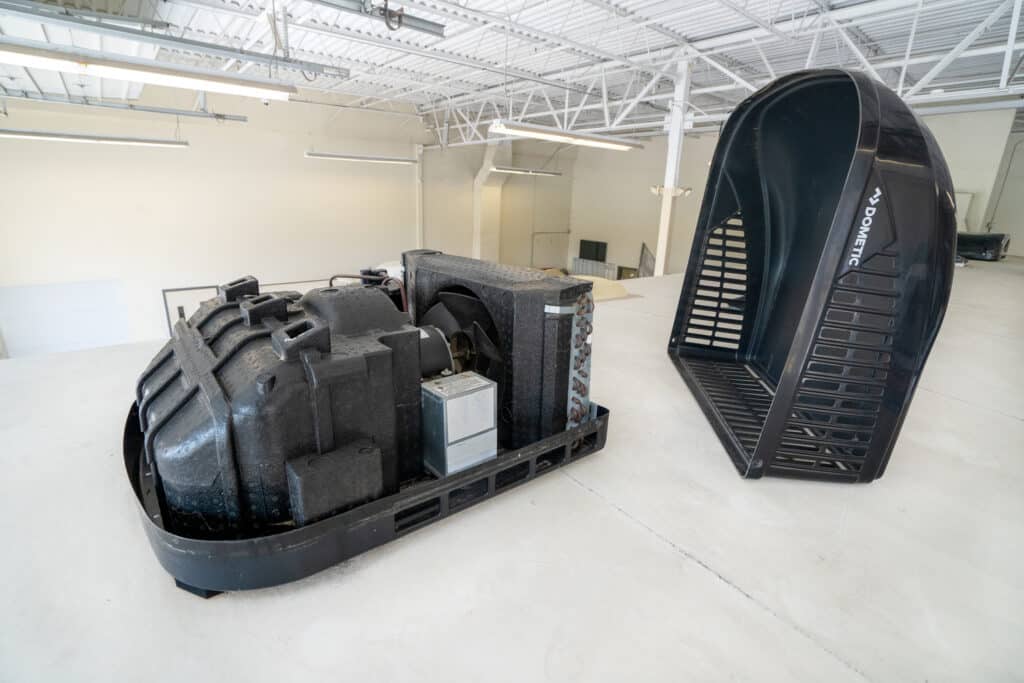

The A/C Unit
The main component of an air conditioner for RV roofs is the unit itself. The unit contains all the internal air conditioning parts, such as the coils, condenser, compressor, etc.

The thermostat tells the A/C unit when to turn on/off. It can be mounted on the wall (electric) or to the distribution box (manual).

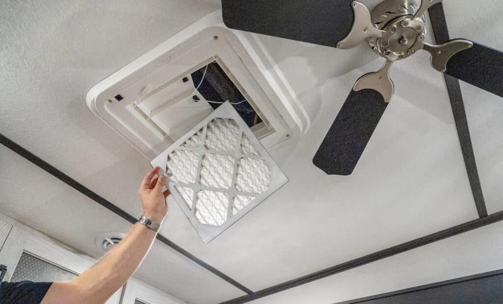

Air Filter
The air filter is installed inside the distribution box in front of the vent. It blocks allergens, such as dust, pollen, mold spores, and more, from entering the RV.

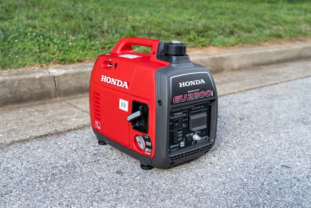

What Size Generator Do I Need for My Air Conditioner?
Generally, most 13,500 BTU RV air conditioners will require at least 3,500 starting watts, and 15,000 BTU RV air conditioners will need upwards of 4,000 starting watts.
When camping off-grid, there’s no access to shore power. Air conditioners draw too much power for your batteries, forcing you to use a portable RV generator. Unfortunately, generator sizing can be tricky. Due to space, weight, and fuel concerns, you’ll usually want to use a generator that is as small as possible.
Like generators, most air conditioners have running and starting wattage requirements. Starting watts represent how much power the unit requires on startup, and running watts represent how much power it needs to stay running. The starting watts can be almost double the running watts. An A/C soft start can reduce the power starting requirements.
