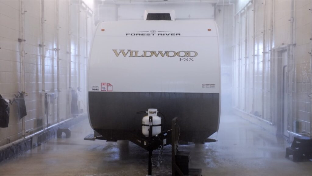

Tip #2. The Truck Wash Strategy
Growing up, my brother and I always groaned when we saw Dad set out those RV exterior cleaning products for our motorhome. We were small, and it was big. But now that I can’t store my trailer on my property, I realize how much easier it was to clean the RV right there in our driveway.
For owners who can’t store their RV at home or those with HOAs that forbid RV cleaning, the question is, “Where can I take my RV to wash it?”
When I owned a sub-20-foot travel trailer, the self-service car wash was a fine option. I just needed to avoid too much water pressure around seams and seals, backing the pressure washer away from the camper. But even with a small trailer, I often had to pay for two cycles to complete a thorough exterior cleaning.
The Hack: Use a commercial truck wash or a mobile detailing service, but with some caveats. You’ll want to skip any “Brighteners” or acidic cleaning agents typically offered. You may also request a lower pressure setting and milder soaps, depending on what they standardly use.
Pro Tip: The “acid wash” or brighteners used for metal trailers will wreak havoc on RV gelcoats, decals, and seals. Specifically request “no brightener or acidic cleaning agents, milder soaps, lower pressure settings, and hand-brush only” to get a professional clean without the damage.

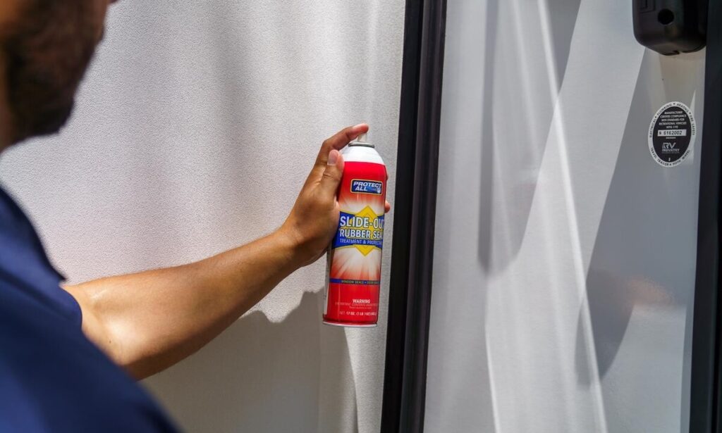

Tip #4. Condition Your Seals
I like to call this tip “The Silent Savior.” Let me explain. Rubber seals are arguably the most easily neglected component of your RV—but they are silent killers because it’s incredibly hard to detect water penetration until it causes significant enough damage to become noticeable, at which point you’ll be looking at expensive repairs.
These seals around slide rooms, windows, and doors invariably dry out. So, it’s time to treat that rubber before it roasts in the mid-summer heat.
The Hack: Open slide rooms, doors, and windows and apply an RV-safe dry silicone lubricant to all exposed rubber seals. Run slide rooms in and out, and slide windows open and closed.
Technician Tip: Campground wisdom may suggest using Vaseline, but petroleum products will essentially melt the rubber seals, so they should never be used.
Why It Helps: Most people wait until seals squeak, tear, or noticeably degrade. Treating them in the spring keeps the rubber supple so it doesn’t “weld” to your RV during the hot summer months, saving you a multi-thousand-dollar repair bill. For slide rooms and windows, lubricating seals also reduces friction, keeping them operating smoothly and reducing wear on the slide motor. For doors, it extends the life of the seal and prevents water damage.

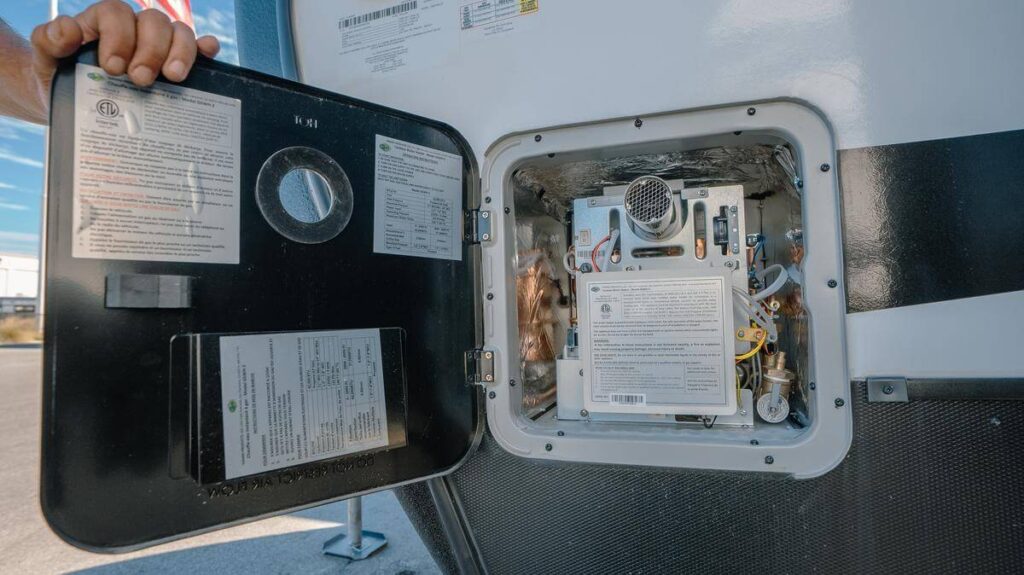

Tip #5. The Water Heater Audit
Regardless of the type of water heater in your camper, there’s a spring cleaning hack to keep it working optimally for your next camping season.
Traditional tank-style water heaters have a sacrificial rod inside that “eats” minerals to prevent the tank from rusting. That sacrificial rod should be inspected during your other spring cleaning checks.
The Hack for Tank-Style Water Heaters: When performing other water system prep (i.e., removing antifreeze, flushing and sanitizing, etc.), remove the anode rod and inspect it. If it’s more than 75% depleted, it’s time for an anode rod replacement.
Why It Helps: When that rod gets depleted, it’s no longer keeping minerals from rusting the tank itself. The anode rod is typically a relatively inexpensive part that can save you from a more expensive full water heater replacement.
But so many RVs (like mine!) now have tankless water heaters. These don’t have traditional tanks or anode rods, but they are subject to calcium buildup.
If you have a “K-Cup” coffee maker at home, you likely know it needs to be descaled regularly. The same applies to on-demand tankless water heaters. Some have a signal light that indicates when it’s time; others may experience reduced water flow, difficulty reaching temperature, or unusual noises from the heater unit.
The Hack for Tankless Water Heaters: Check the heater manufacturer’s recommendations for descaling techniques. This typically involves pumping a 5% distilled white vinegar solution through the heater to remove calcification.
The “Expert” Twist: Most manufacturers will recommend descaling their tankless water heaters annually. If you RV full-time or frequently camp in areas with hard water, you may need to descale more frequently. However, an upgraded water softening system can reduce calcium buildup in your water heater and plumbing.
Watch our video on how to descale a tankless water heater.

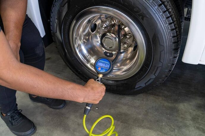

Bonus Tip #6: Torque & Tire Check
There’s arguably no more precarious situation to be in as an RVer than on the side of the highway trying to change a blown tire. I’ve been there more than I’d like to admit—partly because I haven’t always kept up with tire care.
I’ve “kicked the tires” and given them a quick look at the start of every season, but the temperature swings of winter and the stationary weight of your RV sitting on them throughout the offseason require a bit more.
The Hack: Be thorough! Tire pressure should be within the recommended ratings on the RVIA certification label in your camper. Minimum legal tread depth is 4/32 of an inch in most US states. Tread should be worn evenly. Look for significant differences in tread depth from the inside to the outside of the tire. Look for sidewall bulges and cracks that can increase the odds of a blowout. Locate the four-digit DOT code on the sidewall (e.g., “1221” means the 12th week of 2021) to ensure tires aren’t out of their usable date range.
The “Expert” Twist: Check and re-torque those lug nuts! Metal expands and contracts significantly during winter freeze-thaw cycles, which can actually “relax” the tension on your wheel studs. Use a calibrated torque wrench to reset them to your manufacturer’s specs (usually found in your manual or on a sticker near the A-frame) and ensure you don’t lose a wheel on the interstate.
The Pro Rule: Some RV experts call tires that are 5 years or older “May-Pops”—as in, they may pop at any second. Even if the tread looks new, UV exposure and internal dry rot can compromise structural integrity over time. Replacing them on your terms in the driveway is much cheaper than an emergency roadside call and a shredded wheel well.
Technician Tip: Our technical team recommends replacing tires every 5-7 years, no matter how much tread remains. A new set of tires often costs hundreds of dollars, compared to the average cost of blowout damage being thousands!
