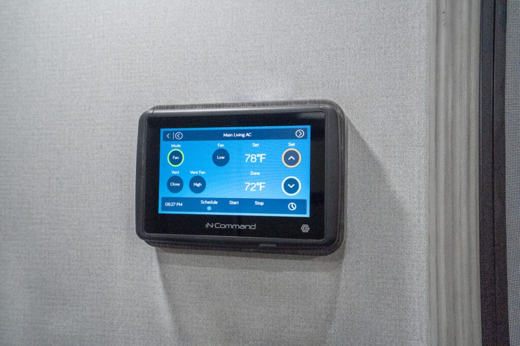

Step 3: Check the Thermostat Settings and Function
Sometimes, the problem is that the AC unit isn’t actually being told to cool. This shows up as the fan running and running without the compressor kicking in. Or, the whole system may seem unresponsive to thermostat changes.
  • Confirm the thermostat is set to Cool mode, not Fan Only.
  • Set the target temperature at least 5°F below the current room temperature.
  • Check the thermostat battery level if yours is battery-powered. Weak batteries are a common, overlooked cause of unresponsive controls.
  • Look at the thermostat’s physical location. Units mounted near a heat source (a stove, furnace, or direct sunlight) can misread the room temperature.
If the thermostat display is working and accepts your input, but the compressor still doesn’t engage, the thermostat itself may be at fault. This is common enough with certain brands that we cover it in more detail in the Dometic-specific section below.
