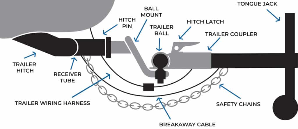

Parts of A Trailer Hitch
First, you must understand the components required to tow a travel trailer safely. This graphic outlines the standard parts of a trailer hitch:

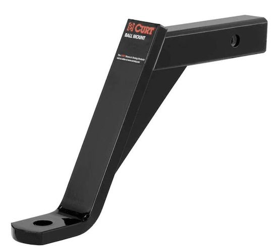

Types of Hitch Ball Mounts
You can also secure various ball hitch mounts into a hitch receiver tube for trailer towing. Like hitch receivers, ball mounts are rated for one of the standard hitch classes.
  • Standard ball hitch mounts feature a single, fixed-size hitch ball.

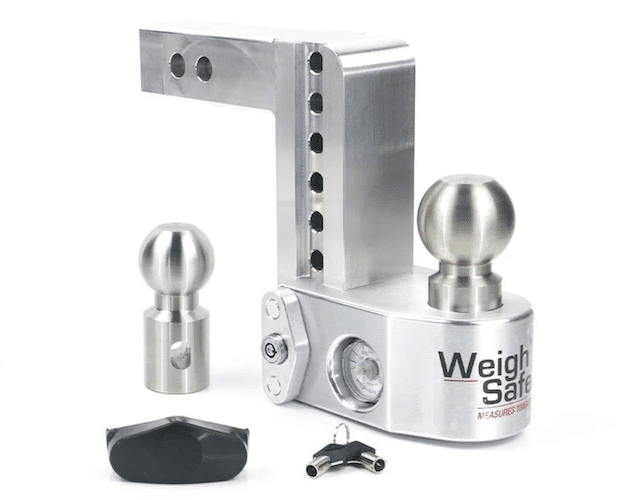

  • Adjustable hitch ball mounts can be raised or lowered based on your towing needs.
  • Cushion ball hitch mounts
  • Deep drop hitch mounts are used when the trailer’s ground clearance is significantly less than that of the tow vehicle.

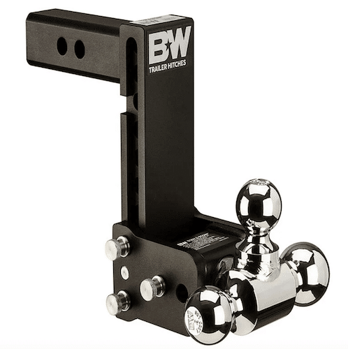

  • Multi-ball hitch mounts generally feature two or more hitch ball sizes, allowing you to rotate the mount and use the preferred hitch ball size for different towables.
  • Pintle hitch mounts offer a strong coupling mechanism with a hook and a ring. They’re mainly used for heavy-duty agricultural or industrial applications.

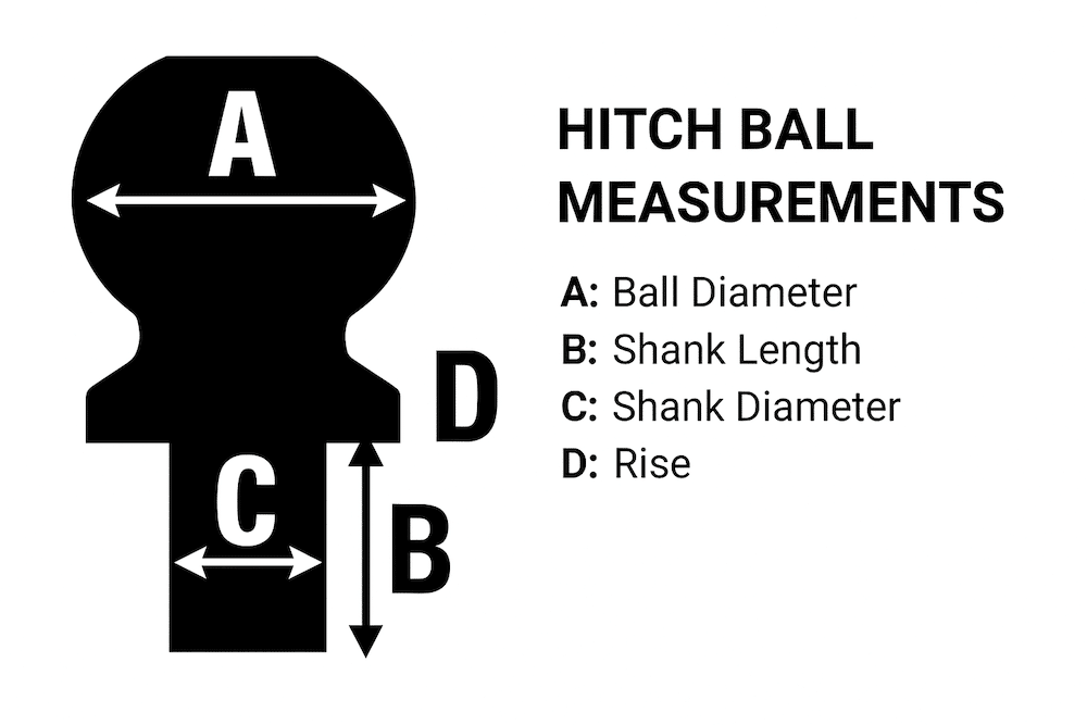

A travel trailer’s coupler fits a specific hitch ball diameter, but diameter is just one of four key measurements that determine compatibility. All dimensions are typically measured in inches.
The four critical hitch ball size measurements are:
  • Ball Diameter: The width of the roundest, widest part of the hitch ball.
  • Shank Diameter: The width of the threaded shaft that mounts the ball to the ball mount.
  • Shank Length: The length of the threaded shaft below the ball’s base.
  • Rise: The vertical distance the ball sits above its base or mounting platform.
Choosing the correct combination of these measurements is essential to ensure a safe and proper fit for your towing setup.

To ensure a safe and secure connection, your hitch ball must match three key measurements:
  • Ball Diameter: Must exactly match the inside width of your trailer’s coupler. It is also stamped on the trailer’s coupler.
  • Shank Diameter: Must fit snugly into the hole on your hitch ball mount. Spacers are available to fit a smaller shank to a larger hole, provided the weight rating of the ball exceeds the RV’s GVWR.
  • Shank Length: Must be long enough to pass through the ball mount with additional thread exposed, allowing the hitch ball nut to be fully tightened.
Choosing the correct combination of these dimensions is essential for proper towing performance and safety.
