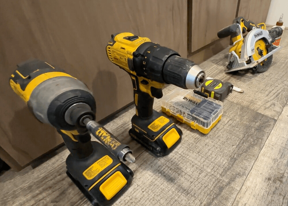

Additional supplies recommended by the camper bed lift kit manufacturer include:
  • Cordless impact driver with Philips bit
  • Cordless drill
  • Drill bit set
  • Measuring tape
  • Marker or pencil
  • Cordless circular saw
  • Construction adhesive/wood glue
While not listed in the instructions, you’ll likely need a ratchet wrench with a ⅜” socket, a small flathead screwdriver, a towel or two, and a headlamp.

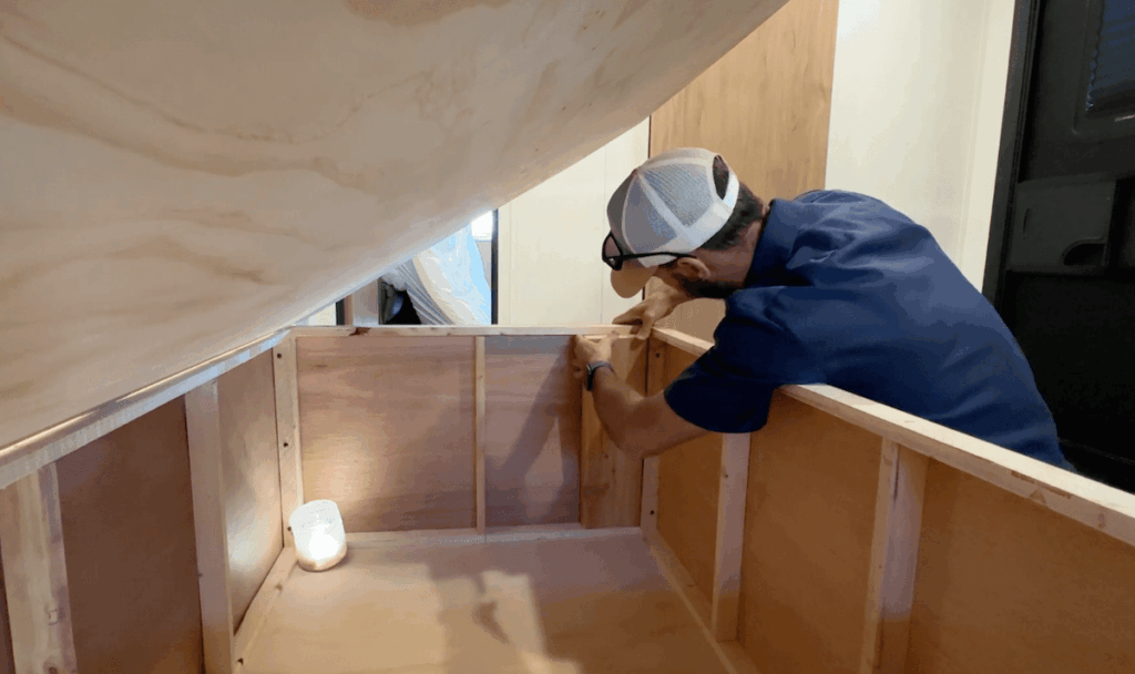

With those blocks in place, remove the mattress and prop the bed platform open to maintain easy access.

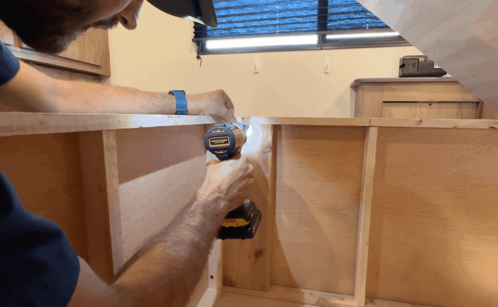

Measure and mark locations for the lower mounting brackets. For this tutorial, we worked on an RV with a partial bed platform, and the kit manufacturer recommends mounting the lower brackets roughly three inches from the outside of the bed frame.
Use a ⅛” bit to drill pilot holes and mount each lower bracket using two of the supplied ⅝” screws.
Hold off on installing the remaining hardware until you’ve tested that the struts operate as expected (after a later step).

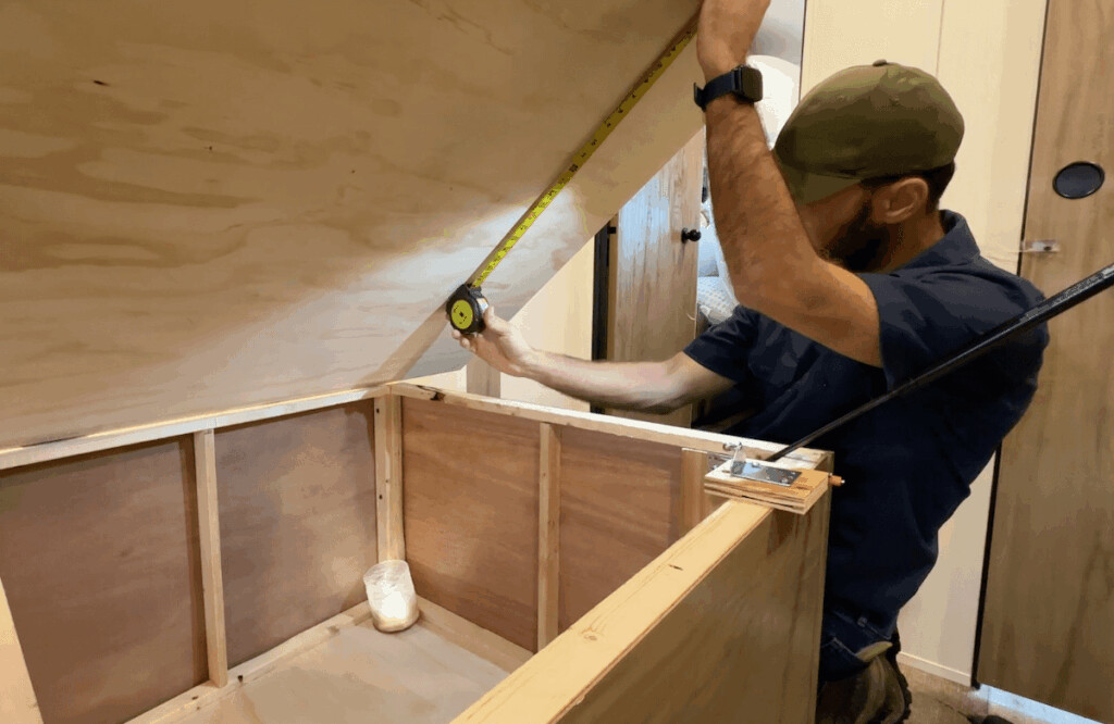

Check the bed height by measuring from the base to the edge of the lifted platform. This RV bed lift kit states that the platform should be propped so that the opening is roughly 24” tall.
Measure and mark the general locations for the upper brackets. The kit states that the upper brackets should be centered roughly 22” back from the edge of the lifted bed platform.

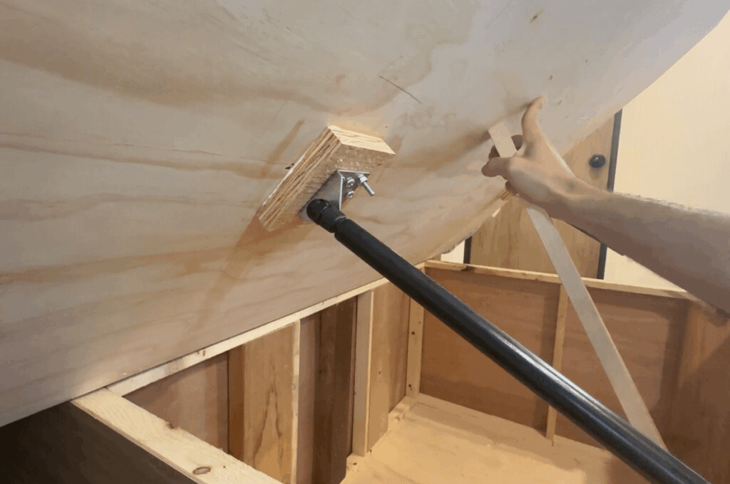

Connect the spring’s upper end to the bracket attached to the wooden block, then position the block on the underside of the bed platform.

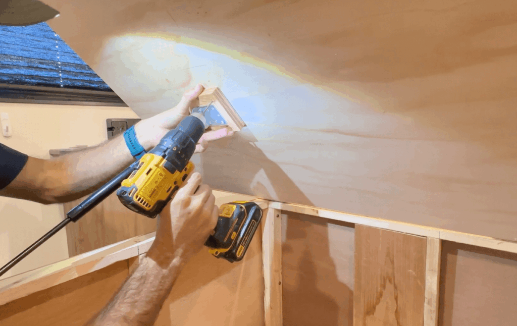

Keeping the strut as vertical as possible, drill pilot holes for mounting the blocks to the bed platform.
Use a 1.25” screw to hold the block in place before removing the strut from the block and installing three more screws from the top side of the platform. This is where you’ll need that flathead screwdriver to remove the struts from the brackets.
You can then move the one screw that held the bracket in place to the top side. This eliminates sharp screw ends from protruding vertically, which could damage the mattress once it’s replaced.
Repeat this process on the other side, then sand the top of the platform to prevent sharp edges from damaging your mattress.

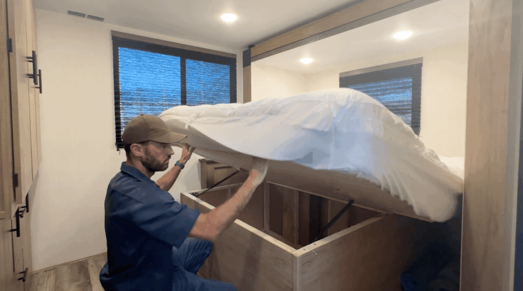

With those upper brackets temporarily secured, reconnect the struts and test them to ensure they work properly. This will require replacing the mattress, as the manufacturer recommends testing the strut operation only with the mattress in place.

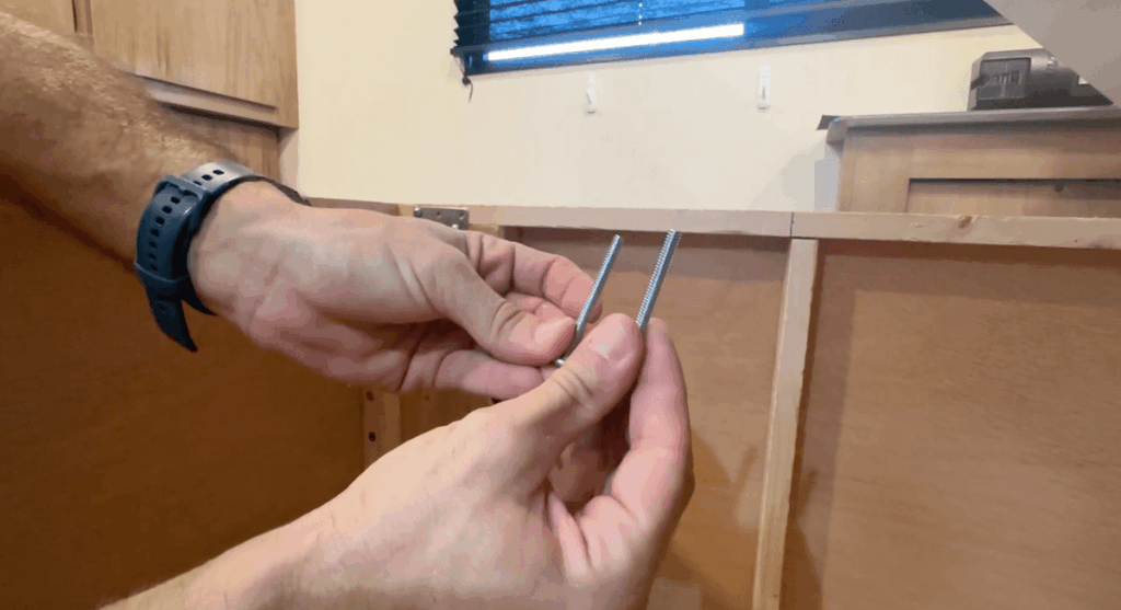

Then, install two through-bolts from the top down and three more ⅝” screws from the bottom up into each bracket. You’ll need a larger drill bit for the through-bolts—we used a 5/32” bit—and a ratchet wrench with a ⅜” socket to secure them.
We also recommend using wood glue to secure the block reinforcements in the corners of the bed frame before securing the bottom brackets. These also will require two additional through-bolts—with the heads installed from the outside—and one more ⅝” screw.
