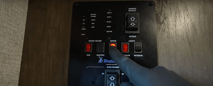

Step 1: Turn Off Your Water Heater and Water Pump
Draining your fresh water system with the water heater on can damage the tank. Turn off your water heater and run hot water for a minute or so to flush out the heated water before draining it. Running hot water for 1-2 minutes should be enough to flush the tank and allow it to cool before draining.
This is also the time to ensure your water pump is turned off. Opening all the faucets in your kitchen and bathroom will allow air to naturally help drain water from your fresh water system (similar to removing the cap on a car’s oil inlet before draining the oil). Then, open the pressure relief valve and remove the plug or anode rod to drain the water heater tank. This is a good time to inspect your anode rod and replace it as recommended by the manufacturer.
Make sure your gray water holding tank is empty before continuing. If you’re in a good location to do so, you can set up your sewer connection to easily empty your RV holding tanks when the time comes.

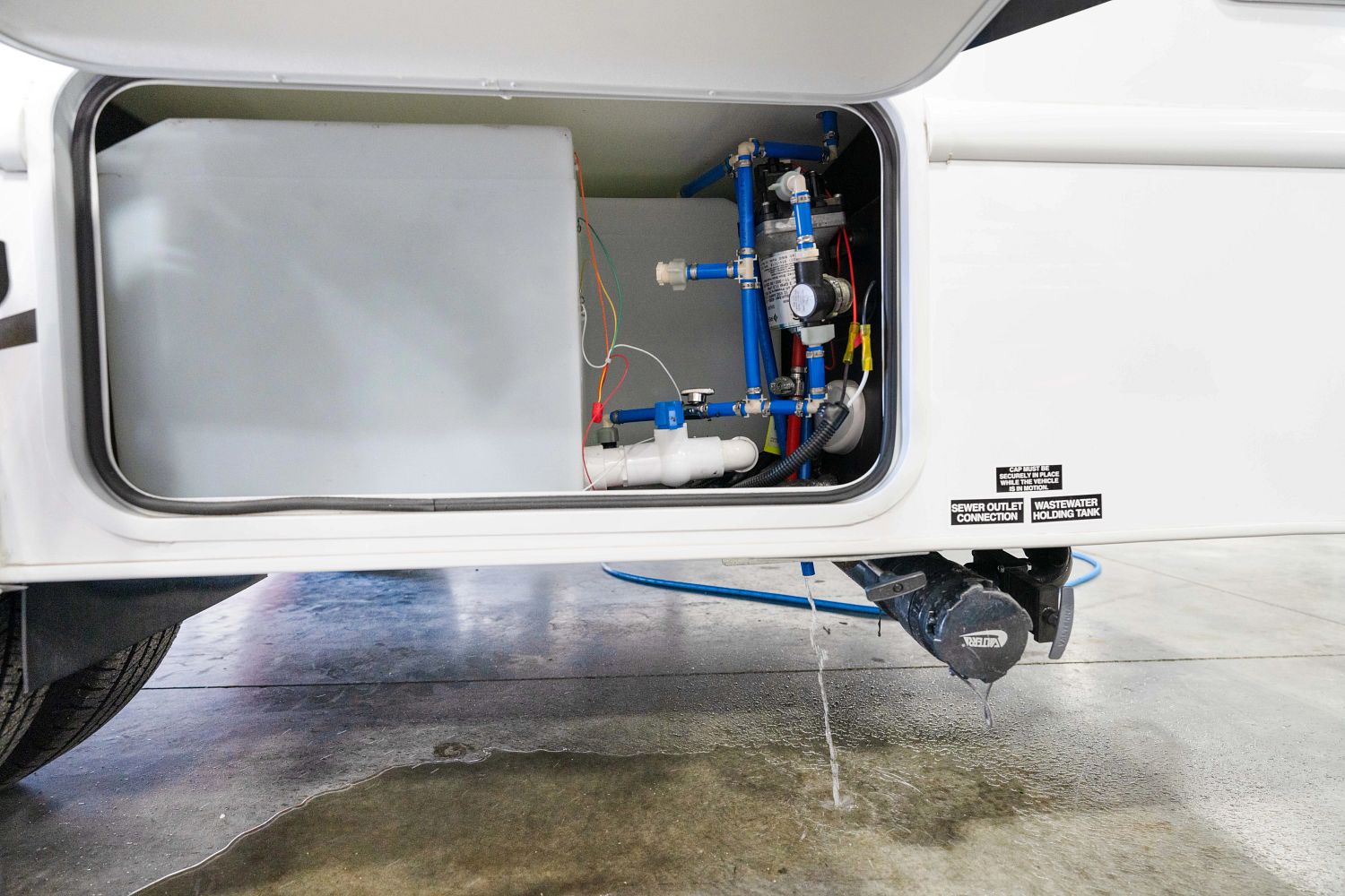

Step 2: Drain The Fresh Water
Fresh Tank Drain. Image by Camping World
Skip to step 3 if your tank is already empty because you drained it when winterizing your RV.

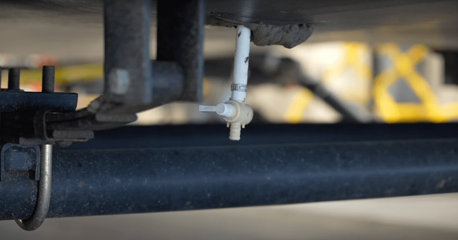

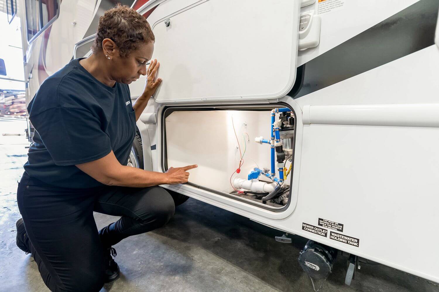

Locate the fresh water tank drain and low-point drains for your RV’s plumbing lines underneath your coach. Most RVs have a drain directly underneath your fresh water tank. Some have multiple drains for the cold water system, depending on the locations of the low points in your coach’s plumbing.
These drains are sometimes easy to identify by red (hot water) or blue (cold water) drains coming out of the bottom of your RV, but some manufacturers use white or opaque PEX. Consult your owner’s manual if you’re having trouble locating these drains on your RV. Once you’ve located them, open the low-point and tank drains to use gravity to drain water from your fresh water tank, plumbing lines, and hot water tank.
Technician Tip: Now is a great time to check your fresh water tank’s hose clamp on the filler tube. This clamp must be tight before your fresh water tank is filled, and it can sometimes be left loose on new RVs. You’ll find this clamp on the side of your fresh water tank closest to the fill inlet. On some travel trailers, the water tank will be in an underneath storage compartment, or it may be located under the bed of smaller trailers.

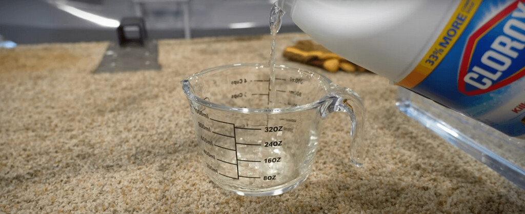

While your system is draining, calculate how much bleach to sanitize your RV water tank. You’ll need about 1/4 cup of bleach for every 16 gallons of water in your fresh water tank. Another helpful ratio is to use one ounce of bleach for every eight gallons of fresh water. Based on these ratios, measure the appropriate amount of bleach for your RV. For example, if you have a 20-gallon fresh water tank, you’d need roughly 2.5 ounces of bleach to sanitize your system.
With your bleach measured, go back and check on those low-point drains. Close them when the water stops draining. STOP! Don’t add the bleach straight to your fresh water tank. Dilute it in at least a gallon of water, then use your funnel to pour the bleach mixture into the fresh water inlet on the side of your RV.

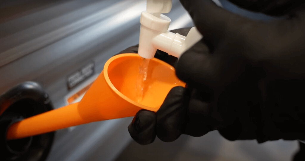

Technician Tip: If your RV has an overfill vent on the fresh water inlet, you may not be able to pour in bleach solution using a funnel. In this case, pour the solution into your hose and hook it up to a water source to get the bleach into your tank.

Ratio: 1/4 cup (about 2 oz) of bleach per 16 gallons of fresh water capacity.

If your RV’s fresh water inlet has an overfill vent that blocks a funnel, pour your diluted bleach solution directly into your fresh water hose before connecting it to your water source. Hold the unconnected end of the hose higher than the connected end, then attach the hose to a water spigot and turn it on. The water pressure pushes the bleach solution through the hose and into the tank, and, as a bonus, it sanitizes the hose.
