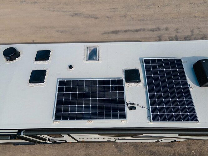

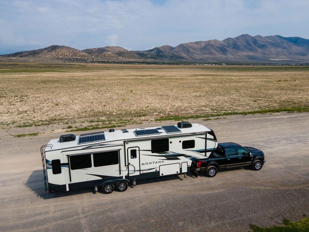

Generally, maximizing your RV’s solar potential is about using available roof space. If you want the maximum solar collection possible, cover as much of your roof with solar panels as is safe and realistic. You must retain space to access a fully walkable roof for repairs and your annual RV roof inspection. Your panels shouldn’t crowd existing roof accessories like your air conditioner and roof vents.

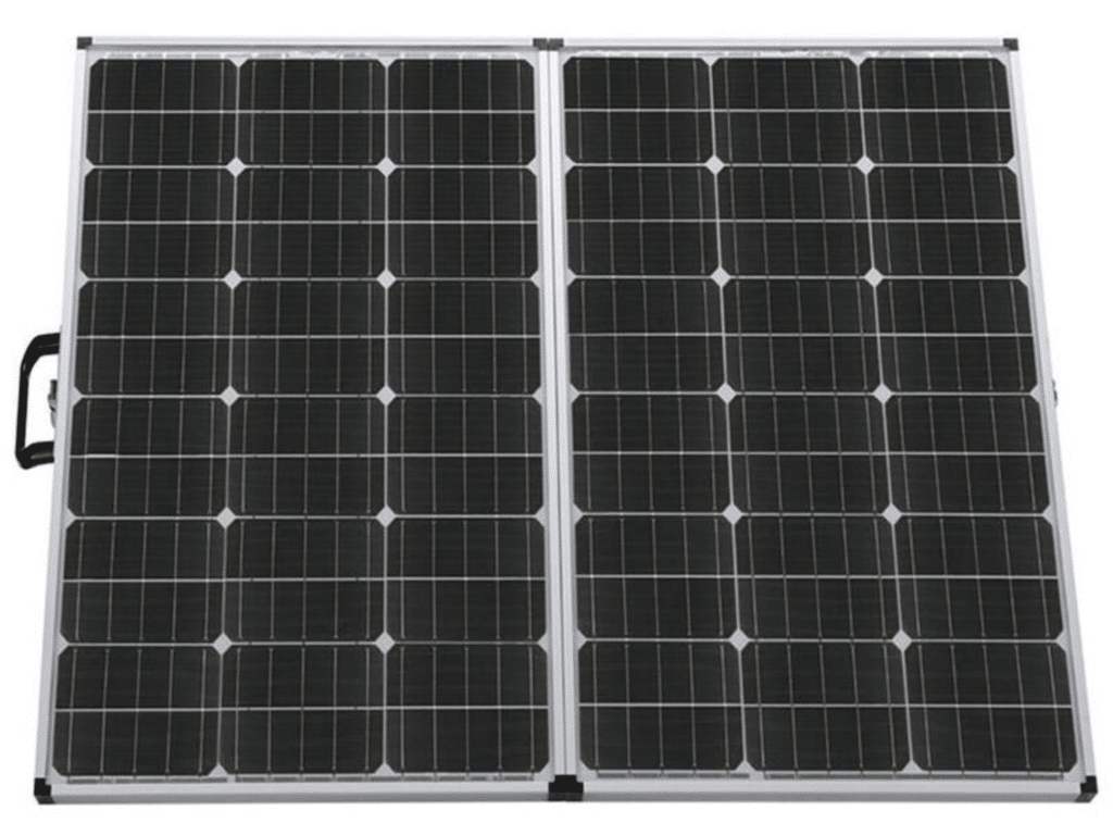

If you’re a full-time RVer who seeks long-term stays, you’ll have more freedom to employ portable solar panels or temporarily mount extra panels on the roof or the ground around your RV. Still, the efficiency of most solar panels makes installing enough – with the proper components – cost-prohibitive as a standalone power source for your RV.

Solar Panels
Solar panels gather energy from the sun and send it through electrical wiring to your system’s charge controller. Adding solar panels allows you to generate more energy, but you may also need to upgrade other components to safely transfer and store it.
There are two types of solar panels: monocrystalline and polycrystalline. Monocrystalline solar panels are more common for RVs because they provide more efficiency for the limited roof space you’ll have on most units.

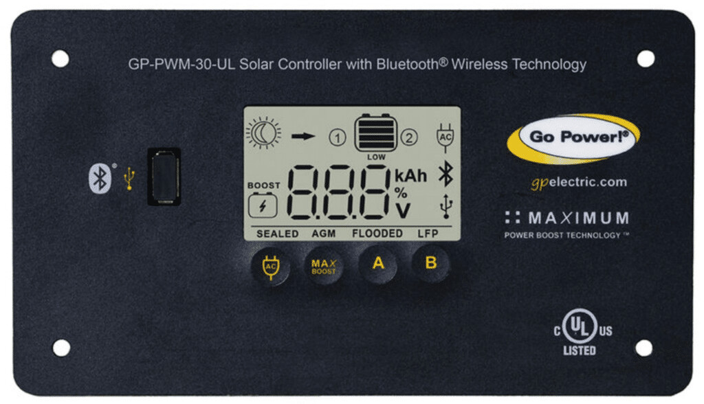

Solar Charge Controller
A charge controller takes the energy your solar panels harness and regulates it down to a useful voltage. The energy coming from your panels varies in voltage. A charge controller is essential for converting that voltage to the 12-15-volt range to properly charge your battery bank.
The two main types of solar charge controllers are maximum power point tracking (MPPT) and pulse width modulation (PWM). PWM controllers use older technology and are less efficient but are more affordable. MPPT controllers cost more, but they’re much more advanced and will deliver greater long-term value for your investment.

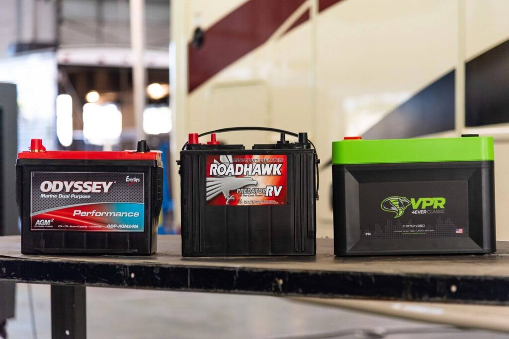

Batteries
Your battery bank provides storage for the energy your solar panels generate. They store energy until you switch on an RV appliance and demand energy from your batteries.
There are three main types of RV batteries: lead acid, absorbent glass mat (AGM), and lithium. Lead acid batteries were the traditional standard, but AGM and lithium batteries are more commonly used in RVs with solar setups today.

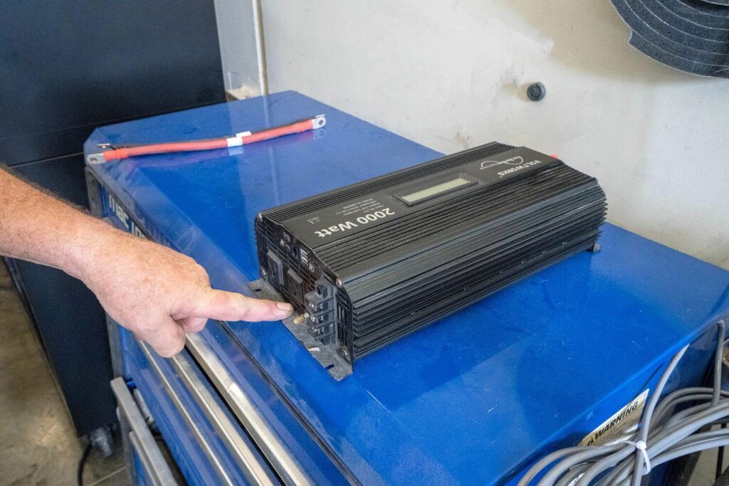

Inverter
An inverter takes the 12-volt energy stored in your batteries and converts it to 120-volt energy to serve outlets and appliances that require that voltage for safe operation. There are several different types of inverters, but RVs with solar should boast a pure sine wave inverter.
Pure sine wave inverters do the best job mimicking the power you’ll get with a household 120-volt plug. They provide the cleanest energy to reduce the risk of damaging sensitive electronics inside your RV.

Choose Your Battery Type
Our total amp-hours guide our choice of the right battery. Our choice will differ based on the type of battery we want.
For lithium batteries, it’s advised to avoid exceeding a depth of discharge of 80%.
That means we must add 20% to our total amp-hours (775 × 1.2 = 930 amp-hours). This converts to a lithium battery bank with a minimum of 11,160 watt-hours of power (930 x 12 = 11,160).
If we choose a 100-amp-hour lithium battery, we’ll need 9.3 batteries to store all the energy consumed daily. You can see how that could be prohibitive, both in terms of storage space and cargo weight.
For AGM and lead-acid batteries, we don’t want to exceed a depth of discharge of 50%, meaning we need to double our minimum amp-hour threshold (775 x 2 = 1,550 amp-hours). This converts to an AGM or lead-acid battery with a minimum of 18,600 watt-hours of power (1,550 x 12 = 18,600). If we choose a 100-amp-hour AGM battery, we’d need 15.5 batteries to store the energy we consume daily. As your depth of discharge increases, you’ll require a larger battery bank (i.e., more energy storage capacity) to compensate.
