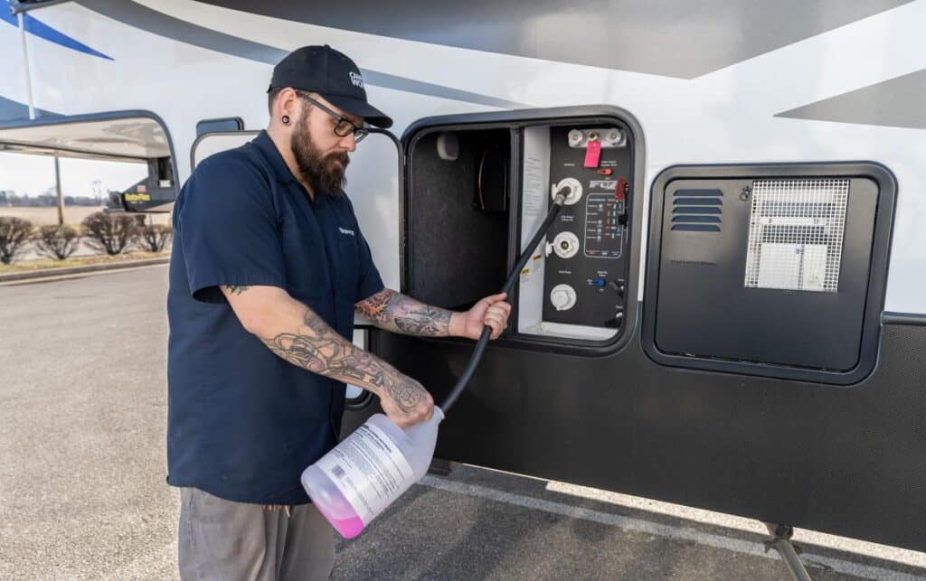

Basic Winterization (blow-out only) uses compressed air to push water out of the plumbing lines. It’s the lower-cost option and works for straightforward RV plumbing systems under the right conditions. However, Basic winterization does not include antifreeze, which provides increased protection (and is required for RVs with some tankless water heaters). Blowing water lines out with compressed air alone can still leave trace amounts of water in the system, leaving it vulnerable to freeze damage.
Complete Winterization blows out the lines and then pumps RV-safe antifreeze through the entire fresh water system. This provides a higher level of protection, is backed by a labor-only warranty, and is suitable for all RV types — including those with tankless water heaters. The Complete package costs more than the Basic package, but it’s the only option that provides documented, warranty-backed protection.
